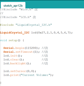

Step 3: Writing the Display Code
This is nothing special, just the standard syntax for using I2C screens with Arduino.
NOTE: You will have to import the Arduino library "LiquidCrystal_I2C.h". Just go to Tools -> Manage Libraries and search up and install the library.
lcd.setCursor() sets the cursor to where you want the text to begin;
lcd.clear() clears the screen;
lcd.print() prints text on the screen;
etc.

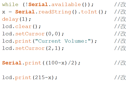

Step 5: Writing the Serial Code for Arduino
Now back to Arduino.This code is needed to get the Arduino to receive the volume value from the PC.
First, make sure the baud rate of the Arduino matches that of the PC/
Serial.begin(115200);
Serial.setTimeout(1);
Then, receive the volume value and turn it back into an integer.
while (!Serial.available());
x = Serial.readString().toInt();
Then print the value.
lcd.print(215-x);
