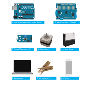

Step 1: Materials You Need
1. Arduino Uno Development Board
2. Adafruit Motor Shield V2
3. Sound Sensors (x2)
4. Step Motor
5. Paper Base
6. Computer
7.Clothespin (x2)
8.Phone
