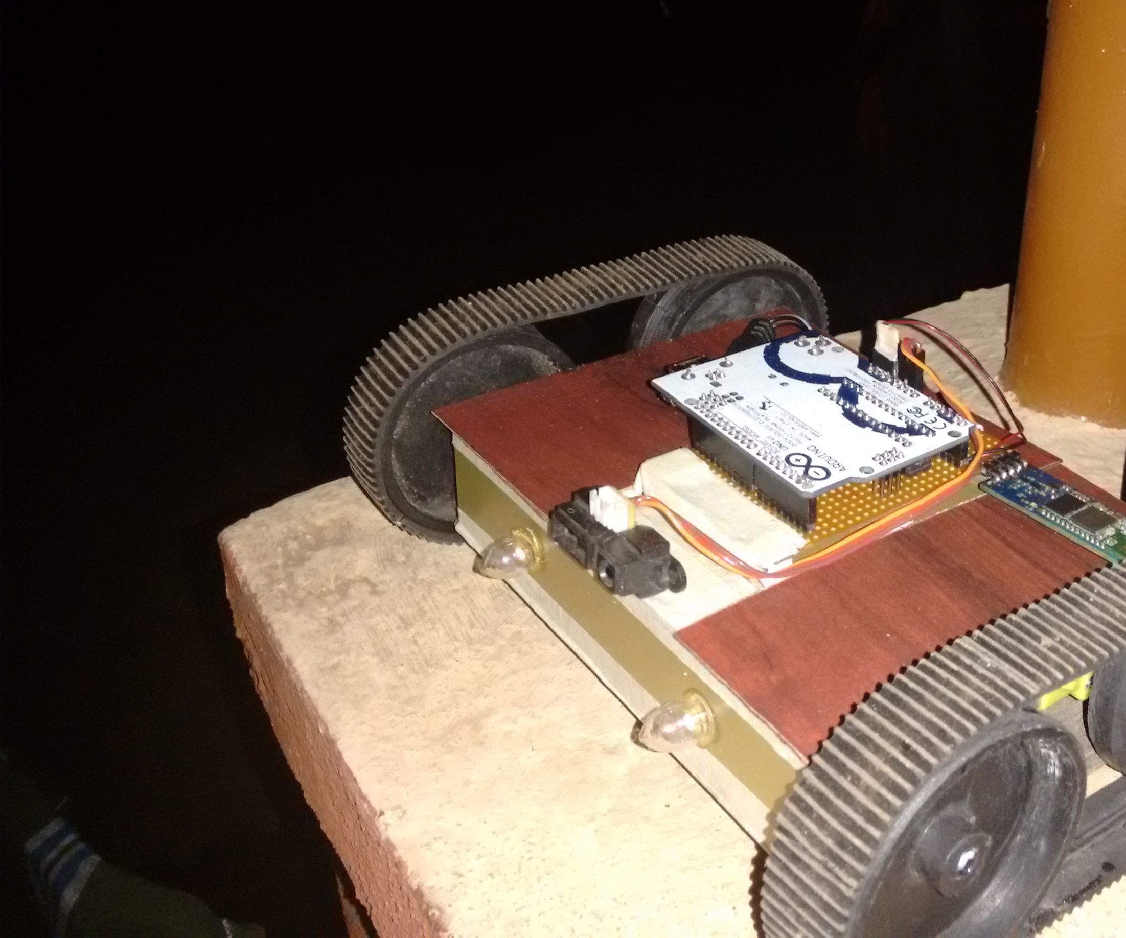

Introduction: Arduino IR Robot
Hello guys today i gone a show you how to built your ir controlled robot..
you can control the robot using any tv remote.....
just follow the simple steps .....
Step 1: Material Requirements ...
1.Arduino
2.LM293 Motor Driver Ic
3.250Rpm dc gare motors
4.12volt battery...
5.IR reciver.
6.TV remote.
7.Etc

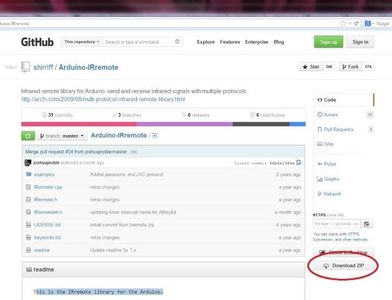

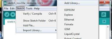

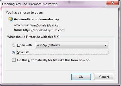

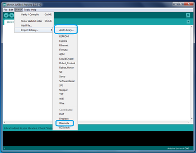

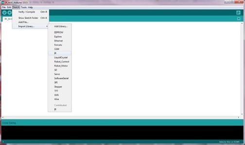

Before you upload the program first u have to upload the arduino IR arduino ir library
visit this to download arduino ir library....
http://arcfn.com/files/IRremote.zip
after installing library ..The IR sensor's pins are attached to Arduino as so: (from left to right with the sensor's head facing you)
