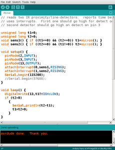

Step 2: Load Sketch
Load the attached sketch into the Arduino.
You will note that it uses the interrupts 0 and 1, which correspond to pins D2 and D3 respectively.
When the sensor attached to D2 senses a nearby object, the time is recorded.
When the sensor attached to D3 senses an object, this time is recorded.
The difference between the two times are reported on the USB/Serial port in microseconds.

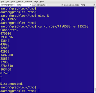

Step 3: Monitor Time on Serial Port
If you just used the Arduino IDE to upload your sketch to the device, the easiest way to use the system is through the Arduino Serial Monitor feature. The IDE should already have the port set from the sketch upload, so just make sure that the serial monitor is set to the correct Baud rate, 115200 in the attached sketch.
Pass an object over the first sensor, and the on-board LED should light up.
Pass an object by the second sensor, and the on-board LED should turn off, and the elapsed time, in microseconds, should be printed to the serial monitor.
If you do not wish to monitor the output using the Arduino IDE Serial Monitor, there are many ways to communicate with a serial port. On Windows the putty program has the ability to communicate to the serial port. The Arduino serial port uses typical defaults, like 8-N-1, so the only setting necessary is the Baud rate of 115200. On LINUX I prefer:
screen /dev/ttyUSB0 115200
Use Ctrl-a k to kill when done.
Another common program for serial communication is cu,
cu -l /dev/ttyUSB0 -s 115200
type "~." to exit.
