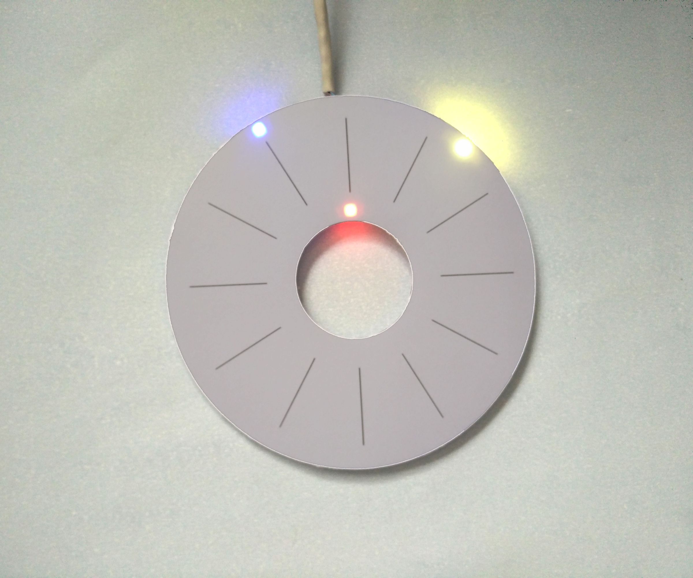

Introduction: Arduino IR Receiver Control Computer
In this tutorial I'm going to explain how to use an arduino as IR receiver, how to connect it to a computer and how to activate functions with the IR remote.
I'll also connect 3 LED's for showing the status of CAPS LOCK, NUM LOCK and SCROLL LOCK.
Let's get started!

Step 2: Circuit
Now we are going to connect everything to the arduino.
So first connect the IR receiver.
Negative connection to ground, positive connection to 5V and signal to pin 2. I've used pin 2 because we'll need this pin for an interrupt.
Now connect the LED's to the arduino. The red LED is connected to pin 22, the green LED is connected to pin 23 and the yellow LED is connected to pin 24.
