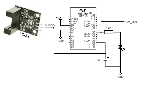

Step 1: Wiring Diagram
This is the proposed wiring diagram of the Arduino Uno Infrared Optical Gate.

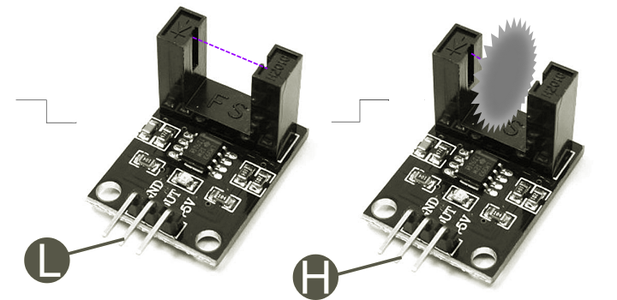

The FC-33 module (at least in my case) uses the H2010 thru-beam infrared sensor (http://www.qtbright.com/static/upload/file/h2010.pdf).
This compact slot/fork sensor has an infrared light emitting diode and phototransistor which are arranged face-to-face on the optical axis within a leaded package so that external light can be blocked.
The LM393 comparator IC in the module is wired to provide a logic-high (H) output signal when an object blocks the invisible light path between the infrared light-emitting diode and the phototransistor.
Normally, the FC-33 module provides a logic-low (L) output, which is indicated by a red indicator embedded in the module.

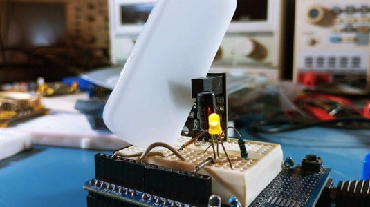

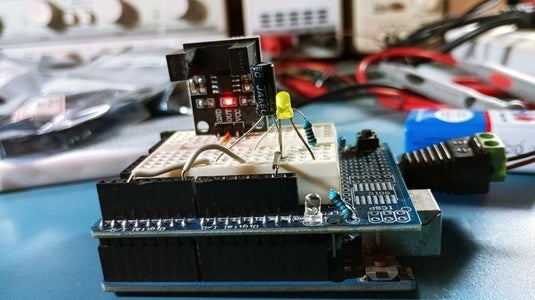

Step 4: Breadboard Prototype
According to the current circuit configuration, Arduino Uno gives a logic-high (H) output on its D7 pin when there is an interruption in the optical gate. The LED wired to that pin also lights up with it.
