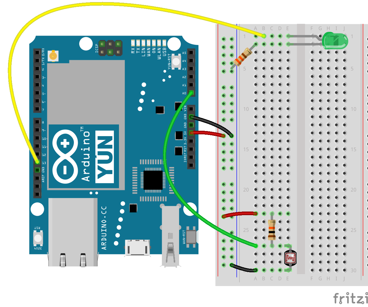

Step 1: Wiring the Arduino
This lessons combines the previous two lessons, so its likely that you already have most of the wiring done from the previous lesson. Wire the Arduino according to the picture at the beginning of this lesson.
Resistors
The 10k Ohm resistor is one part of the voltage divider, working in partnership with the photoresistor.
The 560 Ohm resistor connects to the negative (shorter) lead of the LED.
Wires
This is where building a habit of connecting positive (5V) and negative (GND) pins from the Arduino to the breadboard side-rails starts to pay off. In this lesson the pin coming from GND to the negative side-rail supports both the photoresistor circuit and the LED circuit.
