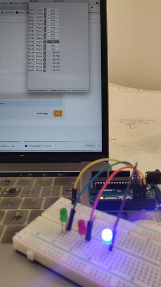

Step 6: Testing Standard Firmata
As mentioned earlier, there are a variety of software packages that make use of Standard Firmata, including Processing, Python pyFirmata, HyperStudio, HyperDuino, and many others.
A quick test can be done using the Firmata Test application. You can download the application from the main Firmata page. Scroll down the page to find the Test application, and download the version appropriate for your desktop machine and operating system. Once you have the application running, use the Port menu item to choose the correct USB port. The Test application should report all of the available digital and analog ports for your Arduino, as shown in the second picture above.
For a more complete test, hook up an LED with a resistor to one of the ports. As seen in the first picture above, we've hooked two wires from the Arduino to a breadboard. The first wire comes from the ground (GND) pin of the Arduino. This wire is connected to a 100 ohm resistor (any resistor between 100 and 330 ohms should work), which in turn is connected to the short leg of a red LED. Finally, the long LED leg is connected to the blue wire which connects to pin 12 of the Arduino (you are welcome to use any of the digital output pins 2 through 13).
In the Firmata Test application, if you select "High" for your output pin, the LED should light up. Selecting "Low" should turn it off.
