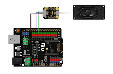

Connect the 6 obstacle avoidance modules: GND and VCC are connected to the breadboard, and the signal lines are connected to the corresponding pins on the Nano.
Write and burn the code.
Power on and test.
Adjust the trimmer (fine-tuning device): Only one green LED should be lit on the module. If both are lit simultaneously, the MP3 module will output abnormal audio.

The Gravity UART module features a variety of pin functions. The TX (T) and RX (R) pins are used for serial communication; the power ground, power positive (3.3V - 5V, including VCC) form the power supply system to ensure stable power supply to the module; The BUSY pin serves as a busy signal pin, presenting a high voltage level during playback and a low voltage level in other states; the SP+ and SP- pins are connected to the speaker and are responsible for audio output; the DACL and DACR pins correspond to the left and right channels of the DAC audio output, respectively; the ONE pin is a single-wire serial port control pin that can be used to achieve specific control functions; The micro USB pin serves as an interface for updating audio files. It connects to a computer via USB, with a storage method similar to a USB drive, facilitating the updating of audio files. The pins work together to enable the module to function in scenarios such as serial communication and audio processing. By dividing tasks among different pins, the module achieves data transmission, power supply, audio output control, and file update functions, providing flexible and practical hardware support for related applications.

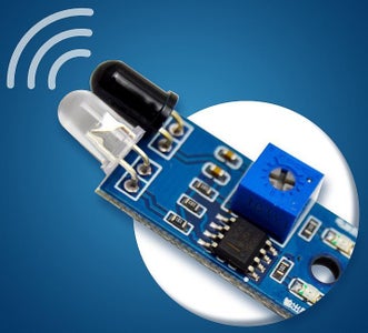

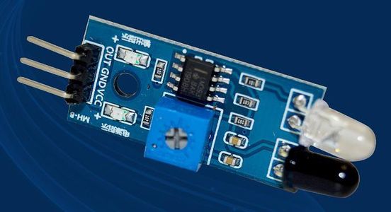

When the module detects an obstacle signal in front, the green indicator light on the circuit board illuminates, and the 0UT port continuously outputs a low-level signal. The module has a detection range of 2–30 cm and a detection angle of 35°. The detection range can be adjusted via a potentiometer: turning the potentiometer clockwise increases the detection range, while turning it counterclockwise decreases the detection range.
This is an active infrared reflection detection sensor with strong adaptability to ambient light conditions. It operates using a pair of infrared emitter and receiver tubes. The emitter tube emits infrared light at a specific frequency. When the infrared light encounters an obstacle, it is reflected and received by the receiver tube. After processing by the comparator circuit, the green indicator light illuminates, and the signal output interface simultaneously outputs a low-level digital signal. The detection distance is related to the target's reflectivity and shape. Black targets and small objects have a shorter detection distance, while white targets and large objects have a longer detection distance. The effective detection range is 2–30 cm, adjustable via the potentiometer knob. The operating voltage is 3.3V–5V, and it can output a digital signal to assist external devices in determining the status of obstacles.

Step 5: Wiring Diagram
