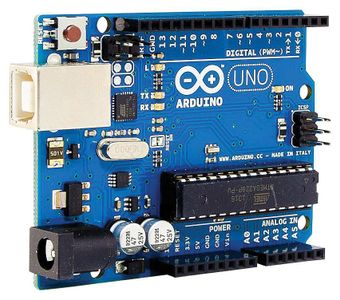

Arduino Uno

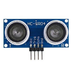

Ultrasonic Sensor

Step 1: About Ultrasonic Sensor
An Ultrasonic Sensor is an electronic device that is used to detect the distance of the object. The sensor converts electrical signals into Ultrasonic Sound waves which travel faster than the Normal Audible sound waves and emits them then receives the reflected sound waves and converts the sound waves into electrical signals and determines the distance of the object.
The Ultrasonic Sensor has to trigger the pulse for at least 10 microseconds (10us).
Pinout of 4 pins:
VCC - positive terminal of the source should be connected.
GND - negative or ground terminal of the source should be connected.
TRIG - Acts as an output that emits the Ultrasonic Sound waves.
ECHO - Acts as an input that receives the reflected Ultrasonic Sound waves.
Datasheet stated features:
  • Operating Voltage: 5V DC
  • Operating Current: 15mA
  • Measure Angle: 15°
  • Ranging Distance: 2cm - 4m
Step 2: About Arduino
Arduino is an open-source microcontroller board running on the ATmega328p microcontroller. The board is consists of digital as well as analog I/O pins.
Coding is done and uploaded by Arduino IDE.
The programming language used by the Arduino is C, C++.
