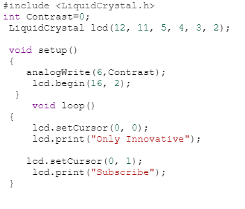

In this project we will only be using a LCD, Arduino uno, jumper wires to display text on the LCD. We will use the digital pin 6 to control the contrast value of the LCD. The function to display text on the lcd will be | lcd.print (“Your text here”) |

Step 2: Code
1) Download the following code.
2) Open the following in Arduino ide.
3) Connect the arduino with your PC.
4) From the tools menu select the port and board correctly.
5) Hit the upload button and the text shall be displayed on your LCD.
