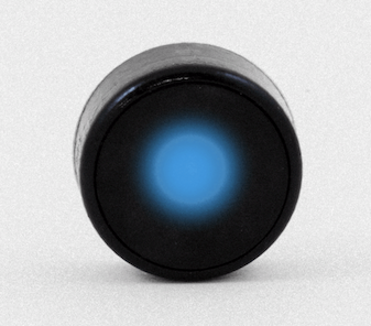

That’s it! Every time you click the button the LED should change state. You now have a working interrupt. It’s up to you to imagine ways to incorporate interrupts into your project. As you can see, interrupts are essential when timing and computation power are important. In the next guide we will cover how to put the ATMega328p into ultra-low power sleep mode, relying on interrupts to wake us up again. Until then, subscribe to us on Instructables and check out our product page at www.doteverything.co. We’re building Dot, an Internet of Things device that we hope you’ll find cool and useful, and through this series of guides we’re going to show you exactly how to build your own version of the hardware!
