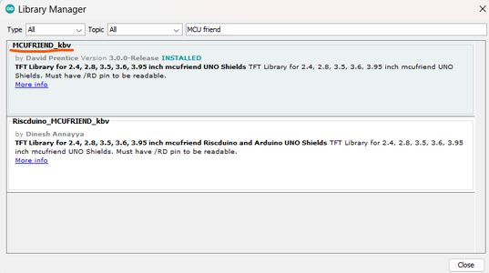

Open Arduino IDE
  1. Go to Tools on the toolbar
  2. Go to Manage Libraries...
  3. Install MCUFRIEND_kbv library

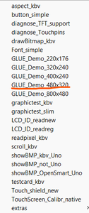

  4. Now, go to File on the toolbar
  5. Go to Examples
  6. Find MCUFRIEND_kbv
  7. Select GLUE_Demo 480x320
  8. Upload the example code to your Arduino

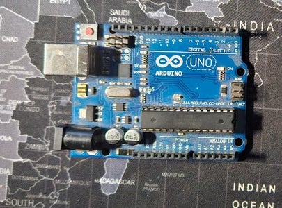

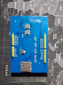

Connect the Shield to your Arduino. Picture given above.

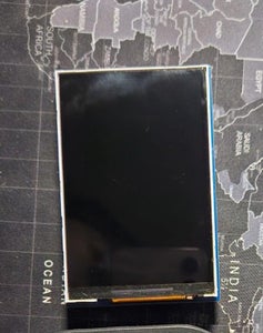

Step 2: Removing the Anti-glare
Now, you can see some areas marked in red in the image above, take a screwdriver and carefully take the screen out of the casing by detaching the metal holder from the screen. You should also remove the LED backlight (the white opaque sheet) and you will get a grey glass; this is your LCD screen. Keep the outer layer of the screen facing up. Then, take a wet cloth and place it over the screen for 2 hours. This will make the screen moist, and the adhesive will be easier to remove.
After 2 hours, you will be able to remove the anti-glare layer. This layer is on top of the polarizer, which we need to remove. Take a screwdriver and try to remove a thin transparent layer by peeling it from the corners. Be very careful and do it slowly.
The anti-glare film is a thin transparent sheet. It gives the screen a matte finish. After removing it, you can throw the film away.
Step 3: Removing the Polarizer
Now take the screwdriver and peel another layer from the screen. This is the polarizer. Now, you have to be very careful to not tear the layers below it. This layer is much harder to remove than the anti-glare layer. To make the process easier, you can place the screen under a wet towel for 2 hours before removing it.
After removing this layer, you can fix the screen back into its casing.
Do not throw the polarizer.
