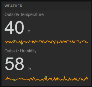

| Outside Conditions | ![]() |

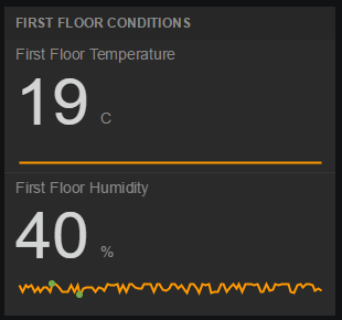

| Inside Conditions | ![]() |

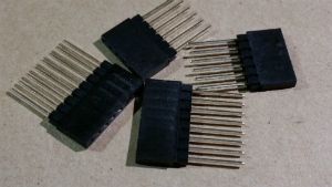

Step 2: Solder on Headers
Neither the CC3000 WiFi shield nor any of the sensors come with headers attached. In order to wire all of our components together, we will solder male headers to all of the connections on the shield and sensors.
Solder Headers to the CC3000 Shield
As with all Arduino shields, we will need to attach headers that will allow the shield to be connected to the Arduino. We will use a special type of header made specifically for Arduino shields, called stackable headers. Stackable headers allow the shield to plug into the Arduino while still allowing our sensors to be plugged into the Arduino through the shield.

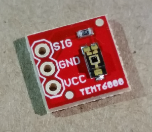

Solder Headers to the Sensors
For the sensors we will use regular male headers. Solder the headers onto the underside of the sensor boards, so that wires plug in from the bottom.

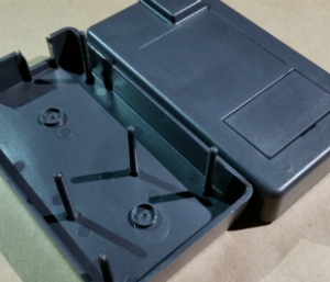

Step 3: Prepare the Project Enclosure
Trim the Mounting Pegs
We will be mouting the Arduino and environmental sensors in a project enclosure just to keep everything together and avoid dangling wires. We will only be using the bottom half of the enclosure since the sensors need to be open to the air in order to work properly.
There is one small modification that needs to be made to the enclosure to properly mount the Arduino. There are four pegs inside the enclosure that we will use to mount the Arduino instead of using bolts. However, these pegs are too tall to place the CC3000 shield on top of the Arduino, so we will cut them shorter.
Using a wire cutter, trim down the pegs to about 1/2 inch tall. Be careful of your eyes when you do this because the ends of the pegs could shoot off at high speed.

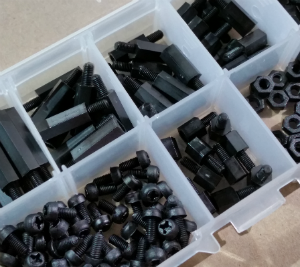

Step 4: Attach Standoffs to Sensors
Now that we have the Arduino mounted in the project enclosure, let's turn our attention to the sensors. We will be using plastic standoffs to mount the sensors in the project enclosure. So, the first step is to attach the standoffs to the sensor boards.
For the temperature/humidity sensor the process will be easy because this sensor has mounting holes. Simply insert a plastic screw through each of the mounting holes and screw a standoff to the bottom.

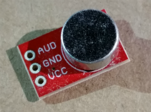

Attaching standoffs to the ambient light sensor and the microphone will be slightly trickier due to these sensors' lack of mounting holes. We will use super glue to attach the standoffs to the bottom of these sensors. Since these sensors are so little, just one standoff for each will offer plenty of strength to hold the sensors in place.
So, first of all put on some latex gloves because getting your fingers super glued together is the worst.

On the temperature/humidity sensor there are two additional pins besides the GND and 3.3V pin: the SDA pin and the SCL pin. Attach a jumper wire to each of these pins. Make sure to use colors other than black and red so you do not get confused later on.
Both the ambient light sensor and the microphone have one additional pin each. Attach jumper wires to these two pins, SIG on the ambient light sensor and AUD on the microphone. Use unique colors for each connection so you can more easily tell which wires attach to which sensors.

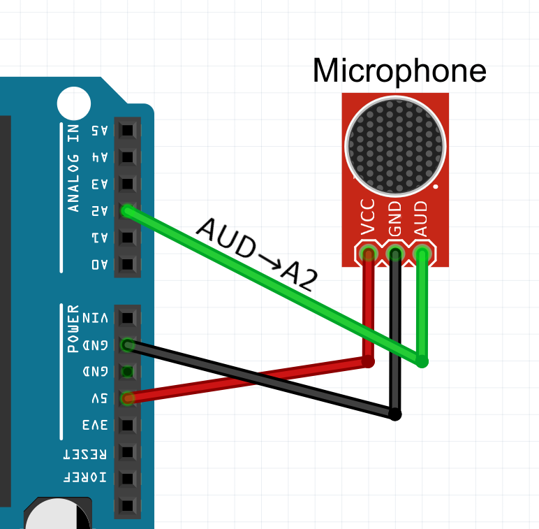

Connecting the Microphone
For the microphone, GND connects to ground, VCC connects to 5V, and AUD connects to A2.

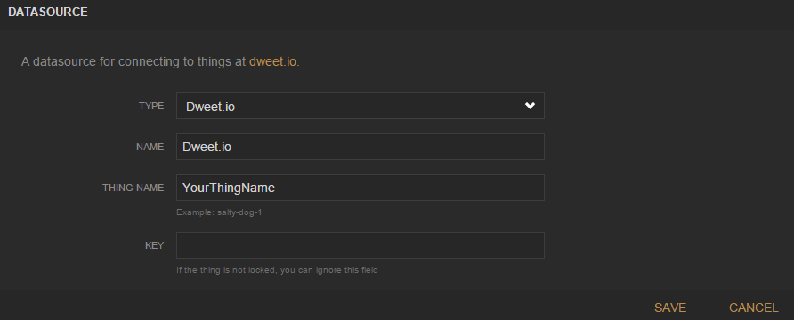

Adding Data Sources

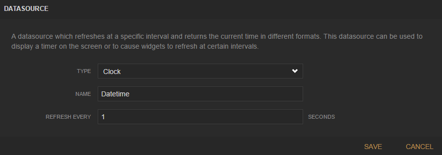

You should now be looking at a blank Freeboard. We will begin the process of setting up the display by adding data sources. Data sources are locations from which our various Freeboard panes will pull information. We will need a total of three data sources:
Begin by clicking the ADD button in the upper-right corner of the screen. In the TYPE dropdown, choose Clock. Once you select this option, two additional options will appear. In the NAME field, give this data source a name that will allow you to differentiate it from the other data sources we will be adding, I named mine Datetime. Then, in the REFRESH EVERY field, input 1 second, which should be the default value. Finally, click SAVE.

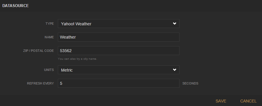

That's one data source down and two to go. Click the ADD button again. This time, in the TYPE dropdown, select Yahoo! Weather. As before, a number of other fields will appear once you select this option. In the NAME field, enter Weather. In the ZIP/POSTAL CODE field, input your zip code. In the UNITS field, choose either Imperial or Metric, depending upon your preference. In the last field, REFRESH EVERY, input 5 seconds. Then click SAVE.
Now for the last, and probably most important, data source. We will add a Dweet.io data source which will allow Freeboard.io to pull information pushed to Dweet.io from our Arduino IoT sensor. Again click the ADD button in the upper-right corner. In the TYPE dropdown, select Dweet.io. In the NAME field, input Dweet.io. Then, in the THING NAME field, input the Thing name you used in your Arduino sketch as described in the previous step. The last field, KEY, will be left blank unless you've paid for a private key on Dweet.io. Last, click SAVE.

That's one Pane finished. We will need to add a total of four more Panes: weather, time, inside conditions, and inside light level. To add our next Pane, click the ADD PANE button again. As before a blank Pane will appear at the top of the page. Click and drag the Pane below the Inside Sound Level Pane we just added. Click the Wrench icon and in the TITLE field input Weather. Leave the COLUMNS field as 1.
Click the + (plus) icon. In the TYPE dropdown, select Text. In the TITLE field, input Outside Temperature. In the SIZE dropdown, select Big. In the VALUE field, input datasources["Weather"]["current_temp"]. Set both the INCLUDE SPARKLINE and the ANIMATE VALUE CHANGES to YES. Last, set the units to correspond with the value, Imperial or Metric, you set for the Yahoo! Weather data source and click SAVE.
Click the + (plus) icon on the Weather pane again and input all the same values you just did except give this Widget a title of Outside Humidity, and in the VALUE field, enter datasources["Weather"]["humidity"].

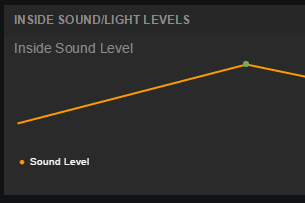

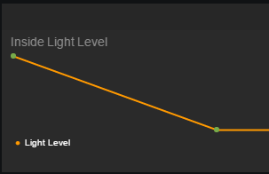

Alright, now let's finish up the Freeboard.io setup with one last Pane. Add another Pane using the ADD PANE button and position it below the Weather Pane. Click the Wrench icon and give the new Pane the title, Inside Light Level, and in the COLUMN field enter 3.
Then add a Widget to the Pane. In the TYPE dropdown select Sparkline. In the TITLE field, enter Inside Light Level. In the VALUE field enter datasources["Dweet.io"]["lightlevel"]. Set the INCLUDE LEGEND field to Yes. Finally, in the SPARKLINE LABELS field, enter Light Level.
