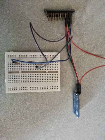

Step 2: Connect Arduino to JY-MCU
You will need voltage divider to connect JY-MCU RX to Arduino TX. I used a 3 x 10 KOhm Resistors. You can use any combination of resistors as long as you get 3.3 Volts going to RX of JY-MCU Module.
- Connect Ground of JY-MCU to Ground of Arduino.
- Connect 5V output of Arduino to Vcc of JY-MCU.
- Connect JY-MCU TX to Arduino RX.
- Connect via voltage divider JY-MCU RX to Arduino TX.
- Connect ground of voltage divider to ground of Arduino.
- Not using voltage divider will result in damaging the module.
