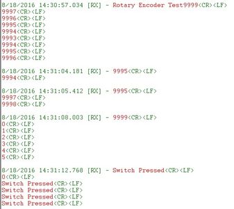

The “rotation”, will be displayed on MAX7219 and printed on serial port for every change in count.
Software, will increments or decrements the “rotation” variable between 0 to 9999.
The increment, decrement or rest value is send to the serial port and will be printed on the connected serial terminal.

The project is successfully completed with Arduino UNO, KY-040 Rotary encoder and Max7219 Seven segment display module.
Detected rotation, and its incremented /decremented values on the serial port screen is given below.

    I had to change where it said "pinMode(PinSW,INPUT);" to pinMode(PinSW,INPUT_PULLUP);" because it treated the encoder button as continuously pressed even though I was never actually pressing it. But that was the only issue I ran into; everything else worked flawlessly. Thank you for posting this. :)
