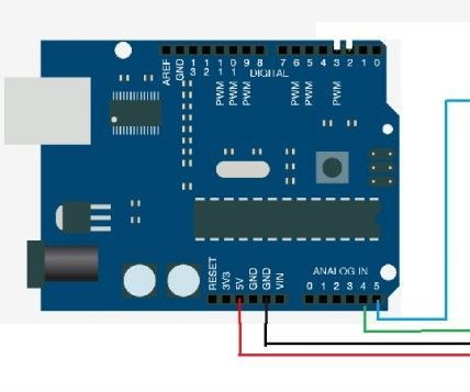

Step 1: Connecting With Arduino
Connecting keypad with aruduino digital pins:
Keypad Pin Connects to Arduino Pin
1 D9
2 D8
3 D7
4 D6
5 D5
6 D4
7 D3
8 D2
