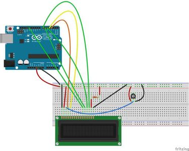

Step 4: Connect LCD Screen
The final step of the electronic components is to connect the LCD Screen.
- Connect one end wire to the ground and the other end to the board.
- Four wires are connected to the pins two to five. Other two wires are connected to the pins 11 and 12.
- The blue wire is attached to the potentiometer, witch is connected to the ground and the pin 5V.
- Three of the black wires are connected to ground and one of the red wires is connected to pin 5V.
- A short red wire is connected to a resistor which is attached to the 5V pin.

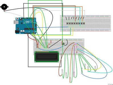

Step 5: Arduino Wiring Diagram
Here is a diagram of how should the circuit look like once all the parts are assembled together.
