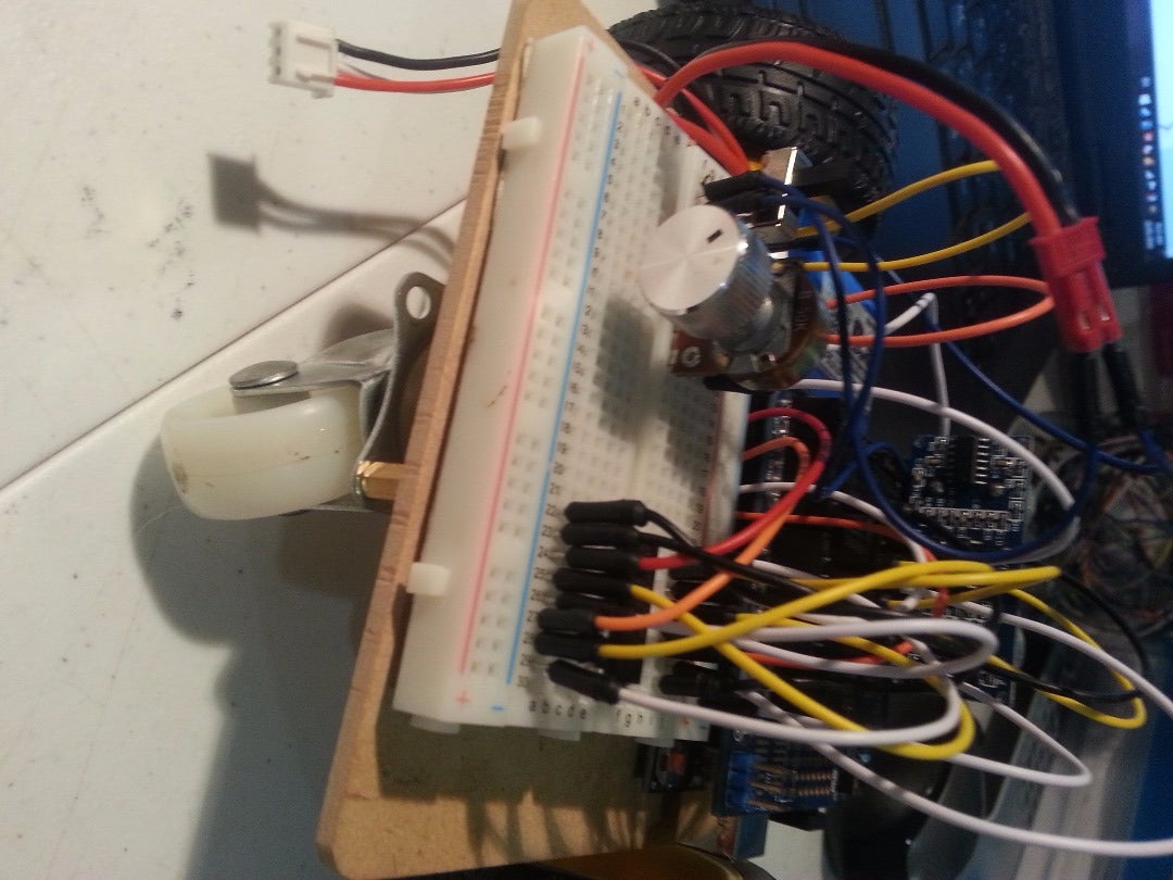

What you need to make it is.
1. Arduino uno.
2. Chassis kit of some sort.
3. L293D Motor driving chip.
4. power supple i used 0.5 mah li-po battery at 7.4v
5. lots of wires
6. ultra sonic distance sensor
7. potentiometer
when you put the code in the robot it will go forward, when the ultra sonic sensor senses something it will reverse and turn left.
Step 1: Wiring
i made this robot with a thin peace of wood 11cm x 11cm
Step 2: Code

Step 3: Touble Shooting
If the robot goes the wrong way swap the motor wires around.
