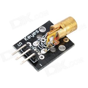

  • Arduino UNO (or any other Arduino)
  • LASER Module

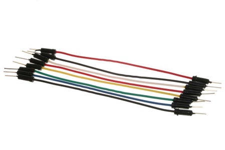

  • Jumper wires

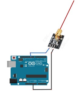

Step 2: The Circuit
  • Connect LASER pin [S] to Arduino digital pin [10]
  • Connect LASER pin [GND] to Arduino pin [GND]

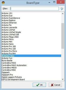

Step 3: Start Visuino, and Select the Arduino UNO Board Type
The Visuino: https://www.visuino.eu also needs to be installed. Download Free version or register for a Free Trial.

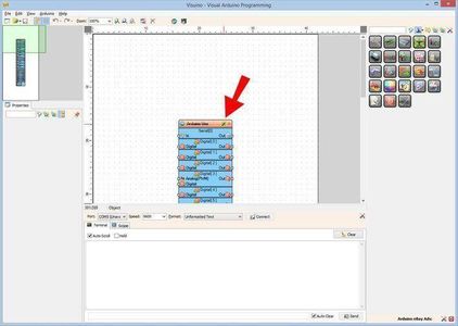

Start Visuino as shown in the first picture Click on the "Tools" button on the Arduino component (Picture 1) in Visuino When the dialog appears, select "Arduino UNO" as shown on Picture 2

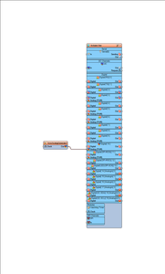

Step 4: In Visuino Add Components and Connect
  • Add "Sine Analog Generator" component
  • Set "SineAnalogGenerator1" component frequency to "0.2"
  • Connect "SineAnalogGenerator1" to Arduino Digital pin [10]
