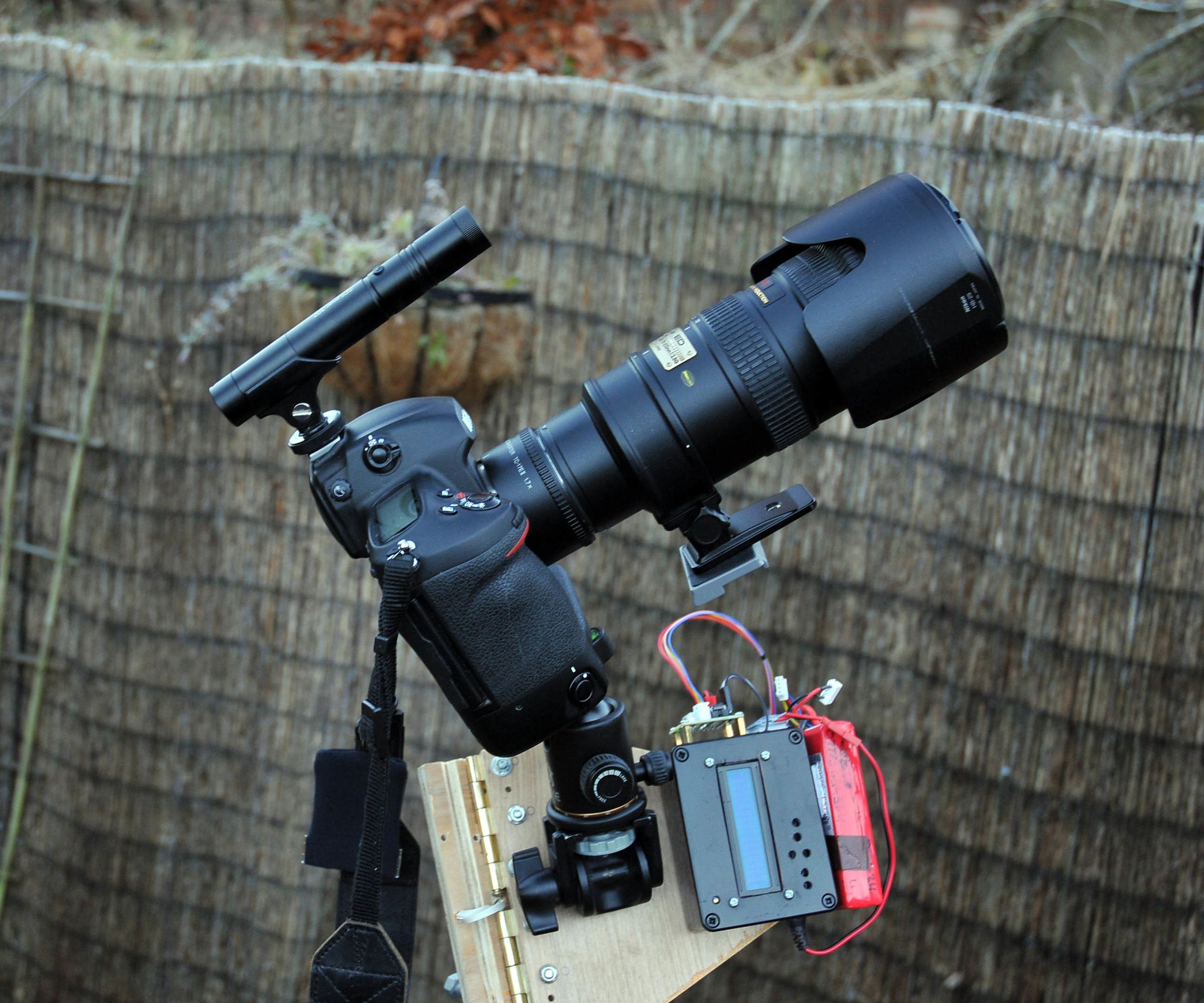

The star tracker Sketch is for use with the stepper motor and Arduino build but the display is set to very dim and can be set within the sketch for brighter or dimmer to suit your needs, here is the link to my build
https://www.instructables.com/id/Star-Tracker-Using...
line 55 pinMode(10, OUTPUT); //Set pin D10 as an output to control the backlight brightness
line 56 analogWrite(10,5); // Set the brightness of the backlight
Lines 55 and 56 set up the pin, then you can experiment with values to get the brightness you need I have set mine at 10,5 has the backlight hardly visible just as I want, 10,255 would be full brightness.
