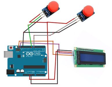

Step 2: Circuit
  • Connect LCD Display pin VCC to Arduino pin 5V
  • Connect LCD Display Module pin GND to Arduino pin GND
  • Connect LCD Display pin SCL to Arduino pin SCL
  • Connect LCD Display pin SDA to Arduino pin SDA
  • Connect Button1 pin VCC to Arduino pin 5V
  • Connect Button1 pin GND to Arduino pin GND
  • Connect Button1 pin Out to Arduino digital pin 7
  • Connect Button2 pin VCC to Arduino pin 5V
  • Connect Button2 pin GND to Arduino pin GND
  • Connect Button2 pin Out to Arduino digital pin 8

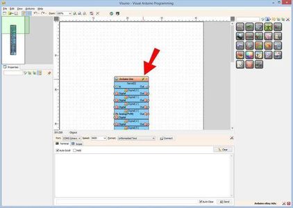

Step 3: Start Visuino, and Select the Arduino UNO Board Type
The Visuino: https://www.visuino.eu also needs to be installed. Download Free version or register for a Free Trial.
Start Visuino as shown in the first picture Click on the "Tools" button on the Arduino component (Picture 1) in Visuino When the dialog appears, select "Arduino UNO" as shown on Picture 2

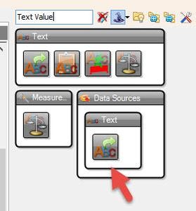

Step 5: In Visuino Set Components
  • Select "UpDownCounter1" and in the properties set Max > Value to 3 and Min > Value to 0
  • Select "ClockMultiSource1" and in the properties window set Output Pins to 6
  • Select "TextValue1" and in the properties window set Value to ">"
  • Select "TextValue2" and in the properties window set Value to "ROW1"
  • Select "TextValue3" and in the properties window set Value to "ROW2"
  • Select "TextValue4" and in the properties window set Value to "ROW3"
  • Select "TextValue5" and in the properties window set Value to "ROW4"
  • Select "LiquidCrystalDisplay1" and in the properties window set Columns to 20 and Rows to 4
Double click on the "LiquidCrystalDisplay1" and in the Elements window:
Drag "Text Field" to the left side and in the properties window set "Column" to 1 and "Initial Value" to "ROW1"
  • Drag another "Text Field" to the left side and in the properties window set "Column" to 1 and "Initial Value" to "ROW2" and "Row" to 1
  • Drag another "Text Field" to the left side and in the properties window set "Column" to 1 and "Initial Value" to "ROW3" and "Row" to 2
  • Drag another "Text Field" to the left side and in the properties window set "Column" to 1 and "Initial Value" to "ROW4" and "Row" to 3
  • Drag another "Text Field" to the left side and in the properties window set "Column" to 0 and "Initial Value" to ">" and "Width" to 1, Select "Row" and Click on the pin Icon and select "Cardinal SinkPin"
Close the Elements window
