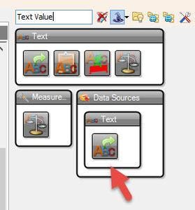

Step 4: In Visuino Add Components
  • Add 2X "Detect Edge" component
  • Add "Up/Down Counter" component
  • Add 2X "Clock Multi Source" component
  • Add 5X "Text Value" component
  • Add "Liquid Crystal Display (LCD) - I2C" component
  • Add "Rotary Encoder Sensor" component.
  • Add "Integer Demux" component
  • Add 4x "Integer Multi-Source Merger" component
  • Add "Start" component.

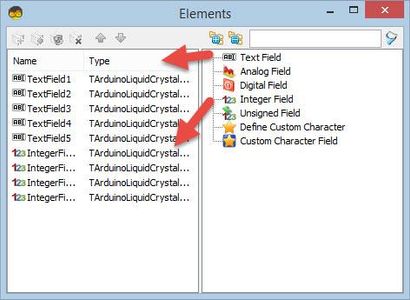

Double click on the "LiquidCrystalDisplay1" and in the Elements window:
  • Drag "Text Field" to the left side and in the properties window set "Column" to 1 and "Initial Value" to "ROW1"
  • Drag another "Text Field" to the left side and in the properties window set "Column" to 1 and "Initial Value" to "ROW2" and "Row" to 1
  • Drag another "Text Field" to the left side and in the properties window set "Column" to 1 and "Initial Value" to "ROW3" and "Row" to 2
  • Drag another "Text Field" to the left side and in the properties window set "Column" to 1 and "Initial Value" to "ROW4" and "Row" to 3
  • Drag another "Text Field" to the left side and in the properties window set "Column" to 0 and "Initial Value" to ">" and "Width" to 1, Select "Row" and Click on the pin Icon and select "Cardinal SinkPin"
  • Drag "Integer Field" to the left, and in the properties window set column to 13 and width to 3
  • Drag another "Integer Field" to the left, and in the properties window set column to 13, Row to 1 and width to 3
  • Drag another "Integer Field" to the left, and in the properties window set column to 13, Row to 2 and width to 3
  • Drag another "Integer Field" to the left, and in the properties window set column to 13, Row to 3 and width to 3
Close the Elements window

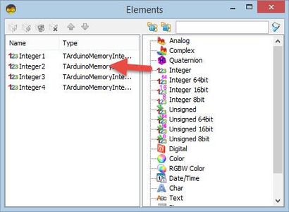

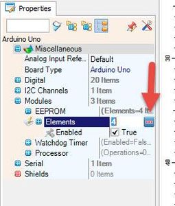

Select Arduino Board and in the properties window expand Modules EEPROM and click on the Elements 3 dots.
  • In the Elements window drag 4 Integer Elements to the left side.
Close the Elements window.

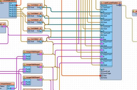

Step 6: In Visuino Connect Components
  • Connect Arduino Digital Pin [7] to DetectEdge1 pin [In]
  • Connect Arduino Digital Pin [8] to DetectEdge2 pin [In]
  • Connect DetectEdge1 pin [Out] to UpDownCounter1 pin [Up]
  • Connect DetectEdge2 pin [Out] to UpDownCounter1 pin [Down]
  • Connect UpDownCounter1 pin [Out] to LiquidCrystalDisplay1 > Text Field5 pin [Row]
  • Connect UpDownCounter1 pin [Out] to ClockMultiSource1 pin [In]
  • Connect ClockMultiSource1 pin [0] to LiquidCrystalDisplay1 pin [Clear]
  • Connect ClockMultiSource1 pin [1] to TextValue1 pin [Clock]
  • Connect ClockMultiSource1 pin [2] to TextValue2 pin [Clock]
  • Connect ClockMultiSource1 pin [3] to TextValue3 pin [Clock]
  • Connect ClockMultiSource1 pin [4] to TextValue4 pin [Clock]
  • Connect ClockMultiSource1 pin [5] to TextValue5 pin [Clock]
  • Connect TextValue2 pin [Out] to LiquidCrystalDisplay1 > Text Field1 pin [In]
  • Connect TextValue3 pin [Out] to LiquidCrystalDisplay1 > Text Field2 pin [In]
  • Connect TextValue4 pin [Out] to LiquidCrystalDisplay1 > Text Field3 pin [In]
  • Connect TextValue5 pin [Out] to LiquidCrystalDisplay1 > Text Field4 pin [In]
  • Connect "LiquidCrystalDisplay1" pin I2C [Out] to Arduino pin I2C [In]
  • Connect Arduino Digital pin [2] to "RotaryEncoderSensor1" pin [Clock]
  • Connect Arduino Digital pin [3] to "RotaryEncoderSensor1" pin [Direction]

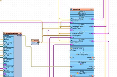

  • Connect Arduino Digital pin [4] to Arduino Integer1 pin [Remember], Integer2 pin [Remember], Integer3 pin [Remember] and Integer4 pin [Remember]
  • Connect "Start1" pin [Out] to Arduino Integer1 pin [Recall], Integer2 pin [Recall], Integer3 pin [Recall] and Integer4 pin [Recall] and "ClockMultiSource1" pin [In]
  • Connect "UpDownCounter1" pin [Out] to "IntegerDemux1" pin [Select]
  • Connect "RotaryEncoderSensor1" pin [Out] to "IntegerDemux1" pin [In]
  • Connect "IntegerDemux1" Out pin [0], pin[1],pin[2],pin[3] to "IntegerMultiMerger1","IntegerMultiMerger2","IntegerMultiMerger3","IntegerMultiMerger4" pin [0]
  • Connect Arduino Integer1 pin [Out] to "IntegerMultiMerger1" pin [1]
  • Connect Arduino Integer2 pin [Out] to "IntegerMultiMerger2" pin [1]
  • Connect Arduino Integer3 pin [Out] to "IntegerMultiMerger3" pin [1]
  • Connect Arduino Integer4 pin [Out] to "IntegerMultiMerger4" pin [1]
  • Connect "IntegerMultiMerger1" pin [Out] to "LiquidCrystalDisplay1" > "IntegerField1" pin [In] and Arduino Integer1 pin [In]
  • Connect "IntegerMultiMerger2" pin [Out] to "LiquidCrystalDisplay1" > "IntegerField2" pin [In] and Arduino Integer2 pin [In]
  • Connect "IntegerMultiMerger3" pin [Out] to "LiquidCrystalDisplay1" > "IntegerField3" pin [In] and Arduino Integer3 pin [In]
  • Connect "IntegerMultiMerger4" pin [Out] to "LiquidCrystalDisplay1" > "IntegerField4" pin [In] and Arduino Integer4 pin [In]
  • Connect "TextValue2" pin [Out] to "ClockMultiSource2" pin [In]
  • Connect "TextValue3" pin [Out] to "ClockMultiSource2" pin [In]
  • Connect "TextValue4" pin [Out] to "ClockMultiSource2" pin [In]
  • Connect "TextValue5" pin [Out] to "ClockMultiSource2" pin [In]
  • Connect "TextValue1" pin [Out] to "ClockMultiSource2" pin [In]
  • Connect "IntegerMultiMerger1" pin [Out] to "ClockMultiSource2" pin [In]
  • Connect "IntegerMultiMerger2" pin [Out] to "ClockMultiSource2" pin [In]
  • Connect "IntegerMultiMerger3" pin [Out] to "ClockMultiSource2" pin [In]
  • Connect "IntegerMultiMerger4" pin [Out] to "ClockMultiSource2" pin [In]
  • Connect "ClockMultiSource2" pin [Out] [0] to "LiquidCrystalDisplay1" "TextField1" pin [Clock]
  • Connect "ClockMultiSource2" pin [Out] [1] to "LiquidCrystalDisplay1" "TextField2" pin [Clock]
  • Connect "ClockMultiSource2" pin [Out] [2] to "LiquidCrystalDisplay1" "TextField3" pin [Clock]
  • Connect "ClockMultiSource2" pin [Out] [3] to "LiquidCrystalDisplay1" "TextField4" pin [Clock]
  • Connect "ClockMultiSource2" pin [Out] [4] to "LiquidCrystalDisplay1" "TextField5" pin [Clock]
  • Connect "ClockMultiSource2" pin [Out] [5] to "LiquidCrystalDisplay1" "IntegerField1" pin [Clock]
  • Connect "ClockMultiSource2" pin [Out] [6] to "LiquidCrystalDisplay1" "IntegerField2" pin [Clock]
  • Connect "ClockMultiSource2" pin [Out] [7] to "LiquidCrystalDisplay1" "IntegerField3" pin [Clock]
  • Connect "ClockMultiSource2" pin [Out] [8] to "LiquidCrystalDisplay1" "IntegerField4" pin [Clock]
