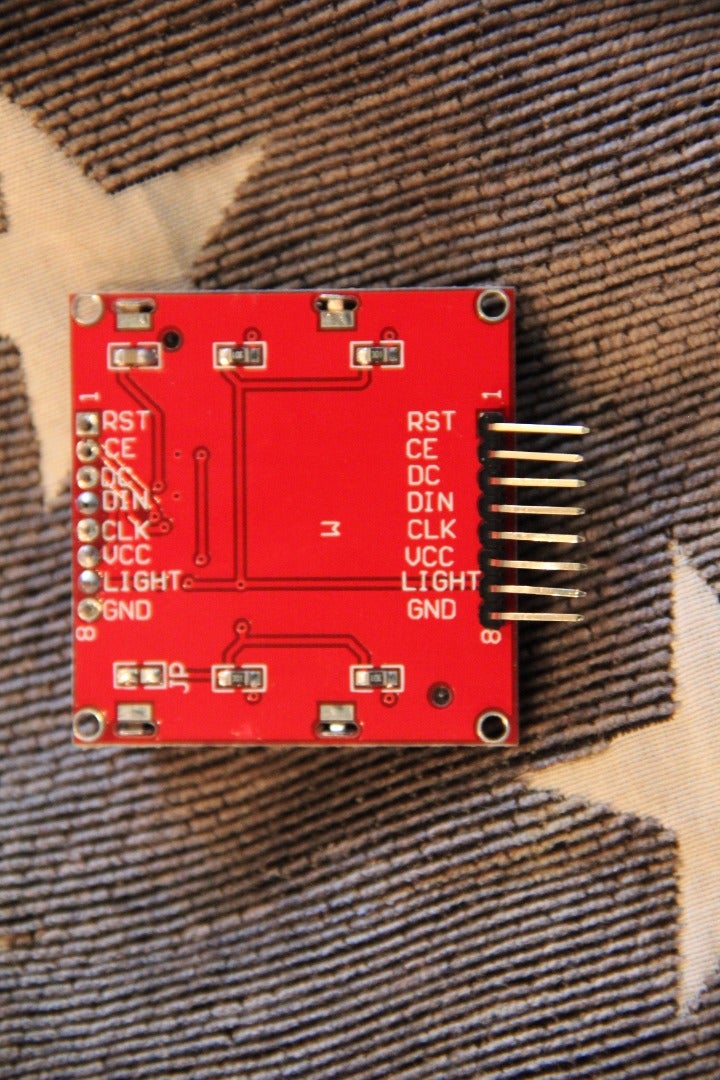

Step 3: Connections (LCD)
As you see at the pictures above, the display runs on 8 pins:
GND, pretty self-explanatory
LIGHT, when this is plugged directly into GND the backlight is on, else if it is connected to VCC or nothing, the backlight will be off.
VCC, goes to arduino power. Remember the display runs on 3.3V and if you do connect it to 5V it might burn out.
CLK, pin for clock signal
DIN (MOSI), pin for data transfer
DC, pin for register select. Pretty much if you wanna send commands or data to the LCD.
CE aka CS, pin for chip select/enable.
RST, pin for reset
Now that you know this, let's connect everything up. Connect it according to the pictures or/and according to the below info:
GND -> GND
LIGHT -> GND (if you want backlight, otherwise VCC)
VCC -> Arduino 3.3V
CLK -> Arduino pin 7
DIN -> Arduino pin 4
DC ->Arduino pin 5
CE -> Arduino pin 6
RST -> Arduino pin 2
Now you can connect these to any pins, but you will need to make the changes in the code which I will not go through in this tutorial. Now, wiring of the sensor we are going to be using:
Step 4: Connections (sensor)
The sensor is fairly simple to connect, basically, GND, VCC and a digital output pin. Same deal, use the pictures and/or the info below to connect the sensor:
Connect the jumper cables to the sensor then connect,
GND -> Arduino GND
VCC -> Arduino 5V (I just used 5 volts because I think this sensor works better with 5V)
Digital output -> Arduino pin 8
