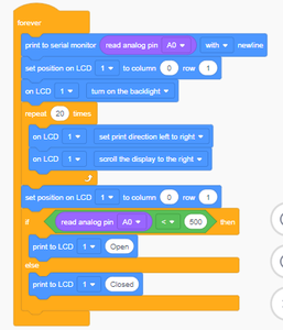

The coding is probably the hardest part of this if you don't know what your doing. So your going to start off with going to the coding tab and changing the first block "On Start" to the first image above. Your going to find those extra pieces in the coding tab labeled "Output". Next your going to go to the output tab find the block labeled "Print to serial monitor ---- With newline" Your going to put that at the top of the forever yellow block. Your going to next go to input and click on the block saying "read analog pin A0" your going to put that block where it says "hello world". Your then going to complete the rest of the coding based off of the second image. I will also explain most of it here. You will be able to find all of the blue blocks in the tab labeled "Output". All of the yellow blocks in the tab labeled "Control". Once you have reached the part where you are required to add in green and yellow blocks you may be confused. What your going to do is click on the tab labelled "Math" and your going to drag the block that looks like the third image into the "IF" spot in the yellow block. Your then going to get another purple block from the "Input" tab. Your going to put the block that says "Read analog pin A0" into the left side of the math block. The number on the right side of the math block is the sensitivity of the photoresistor the lower you go the less sensitive it will be. Your then going to complete the rest as following the second image.

Through out the code you will notice spaces you can type words In my example I used words like Bathroom and open and close which is what I was using this for. To tell if the bathroom was open or closed based off of the light level in the room. Whatever you are going to or use this system for rather if its just for fun or for an actual purpose you can change those words in relation to what they are used for. Like you can change bathroom to Classroom or other stuff like that. Your final project should look like the images in the beginning of the instructions.
