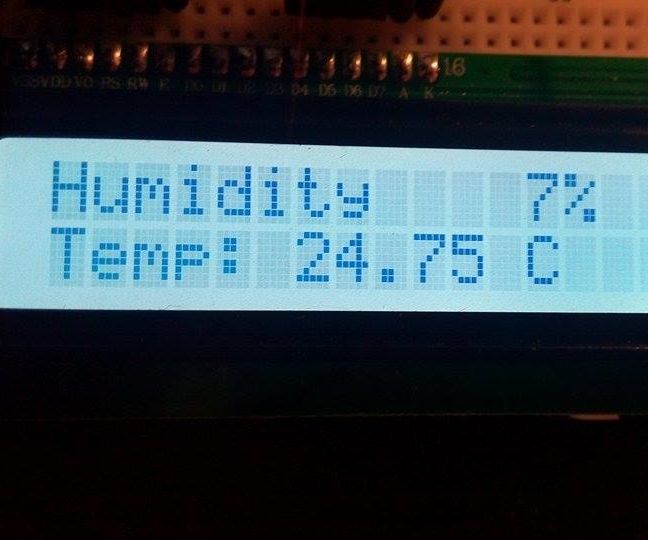

Step 5: Add the Power Supply
Add the proper power supply (5-9V should be fine) and set the contrast of your LCD with the potentiometer. Also set the potentiometer on the YL-69 moisture sensor if the red light on the small board is not on. What you should get is as its shown on the picture, but instead of Wilgotnosc you ll get "Humidity", as Humidity is wilgnotność in my language. Check if the sensor is working properly with a cup of water.
