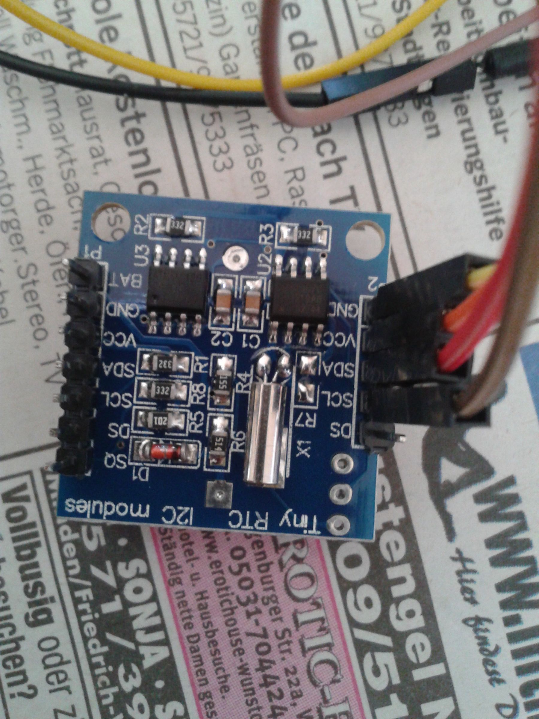

September 23 2013 added RTC ( realtimeclock ) Ds1307 (step 11)

1 RTC DS1307 step 11
1 time / DS1307RTC libraries http://playground.arduino.cc/Code/time

Step 11:
Conect the RTC ds1307 to Arduino.
conect SDA to Arduino A4.
conect SCL to Arduino A5.
conect vcc to +5v
conect gnd to gnd.
conect vcc to +5v
conect gnd to gnd.
Step 12: Upload This Sketch to Add the Rtc to the Projekt. to Be Continued.
