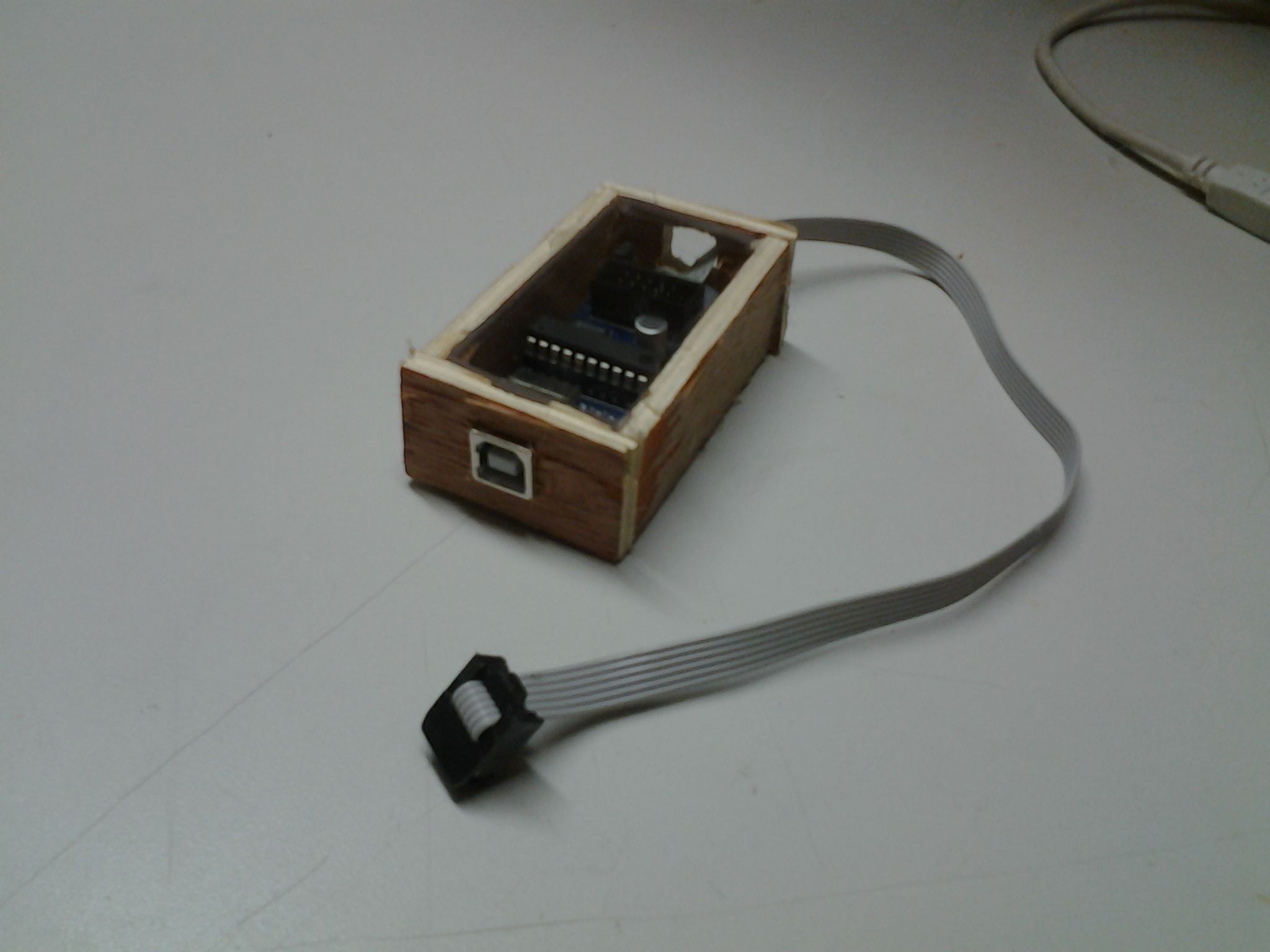

Step 4: The Final Product
Now I know this isn't the best looking project enclosure as you saw in the intro, but here's how I did it. I use 1/4 plywood type of scrap kind of wood, and you can check the Home depot for it and look carefully. I cut it up to size and nailed it together with an air compressor nailing gun. It actually didn't split,( Take your time or it will split!) No glue is necessary. I drill hole for the wire like the thermister and 3 wires for the separate relay power control box, and drilled one big one were the lcd was supposed to go. This was so I could stick a jigsaw blade in there and cut out a rectangle. The 2 tactile switches had tall shafts which poked through the plywood just barely. You could glue or epoxy on plastic rods from a pen tube or something.
Also I embedded an atmega8 not an atmega328 just because my sketch was only 6k bytes. The atmega8 only holds 8k bytes so I was safe. I pretty much made a stand alone arduino on perboard. I used a voltage divider for the lcd which was 1k and 220 ohm resistor. 1k goes to 5 volts and pin 3 on the LCD, and the 220 ohm resistor goes to ground and the pin 3 on the LCD.
To prop up the board to the front panel. The 3 pin header connector was from the connection the the relay power box.
I used an iec connector, I soldered a main female connector to this one so I can plug it in the box. I used hot glue this time for the box and it worked surprisingly well.
Remember to comment or contact me if you have any problem. Any go to arduino.cc and arduino forums or more troubleshooting and help.
