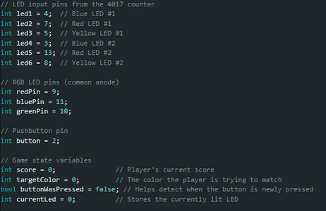

Step 5: Declaring & Initalizing Through Code
At the very top of your code, you will need to initialize all of your variables. By initializing the variables, you’ll be able to control the pins of the Arduino and manage how your components interact in the game. All of the variables with “led” in them are connected to the outputs of the 4017 decade counter (these are the LEDs that will light up in sequence). The variables with “redPin,” “greenPin,” and “bluePin” are used to control the RGB LED colours. The “button” variable is linked to the pushbutton input. The remaining variables are for the game logic. See the image above of all the variables used for your program.

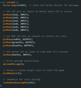

Step 6: Setup Function
Now that all of your variables are initialized, you need to set them as either inputs or outputs so the Arduino knows how each pin should behave. You can do that using this line of code:
pinMode(variableName, INPUT); or pinMode(variableName, OUTPUT);
In this project, all of the LED variables (led1 to led6) are connected to the outputs of the 4017 decade counter. Since those pins are receiving pulses, they need to be set as inputs. This way, the Arduino can detect when a specific LED is on. Next, you have the RGB LED pins (redPin, greenPin, and bluePin). These pins are sending signals to light up different colours, so they need to be set as outputs. The pushbutton is also receiving input from a press, so that pin (button) should be set as input as well.
At the bottom of the setup() function, you’ll see randomSeed(analogRead(0));
This line ensures the random colour selection later in the game picks different colours each time the game runs. By writing this setup function, you are activating all of your components and getting the game ready to begin. Now that this part is complete, we can move on to the main part of the code, the loop() function.

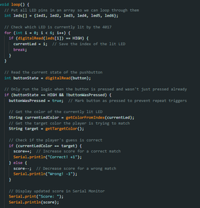

Step 7: Main & Looping Function
The loop() function runs continuously while the Arduino is powered on. First, it creates an array with all the LED pins so it can easily check each LED to see which one is currently lit. It does this by reading the state of each LED pin, and when it finds the one that is HIGH (on), it saves that LED’s position in the variable currentLed. Then, it reads the state of the pushbutton to see if it is pressed.

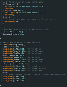

When the button is pressed, the code compares the colour of the currently lit LED to the target colour the player is trying to match on the RGB LED. If the colours match, the player’s score increases by one, and a “Correct! +1” message prints in the Serial Monitor. If the colours don’t match, the score decreases by one, and a “Wrong! -1” message appears. The updated score is then shown on the Serial Monitor. If the player reaches a score of 5, they win, and the game resets. If the score reaches -5, they lose, and the game also resets, generating a new random target colour to display on the RGB LED for the next round.
Beyond the loop(), there are several helpful functions. The setColor() function controls the RGB LED to display the target colour that the player must match. Because it’s a common anode LED, it uses specific values (inverted of common cathode) in analogWrite() to turn the red, green, and blue pins on or off (to show blue, red, or yellow colours).

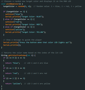

The pickNewColor() function randomly chooses the next target colour and updates the RGB LED to show that colour. It also prints the chosen colour and instructions to the Serial Monitor, so the player knows what to do next.

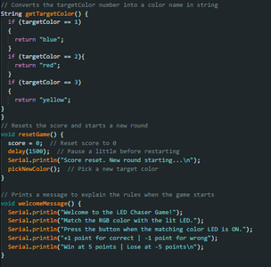

The getColorFromIndex() function takes the position of the lit LED and returns its colour as a string, matching specific LED positions to blue, red, or yellow. Similarly, the getTargetColor() function converts the random target colour number into a colour name string for the comparison in the game.
The resetGame() function resets the player’s score to zero, pauses briefly to let the player get ready, and then picks a new target colour to start a fresh round. It also prints messages to the Serial Monitor informing the player about the reset.
Lastly, the welcomeMessage() function runs once at the start to print the game’s instructions and rules to the Serial Monitor, helping the player understand how to play.
