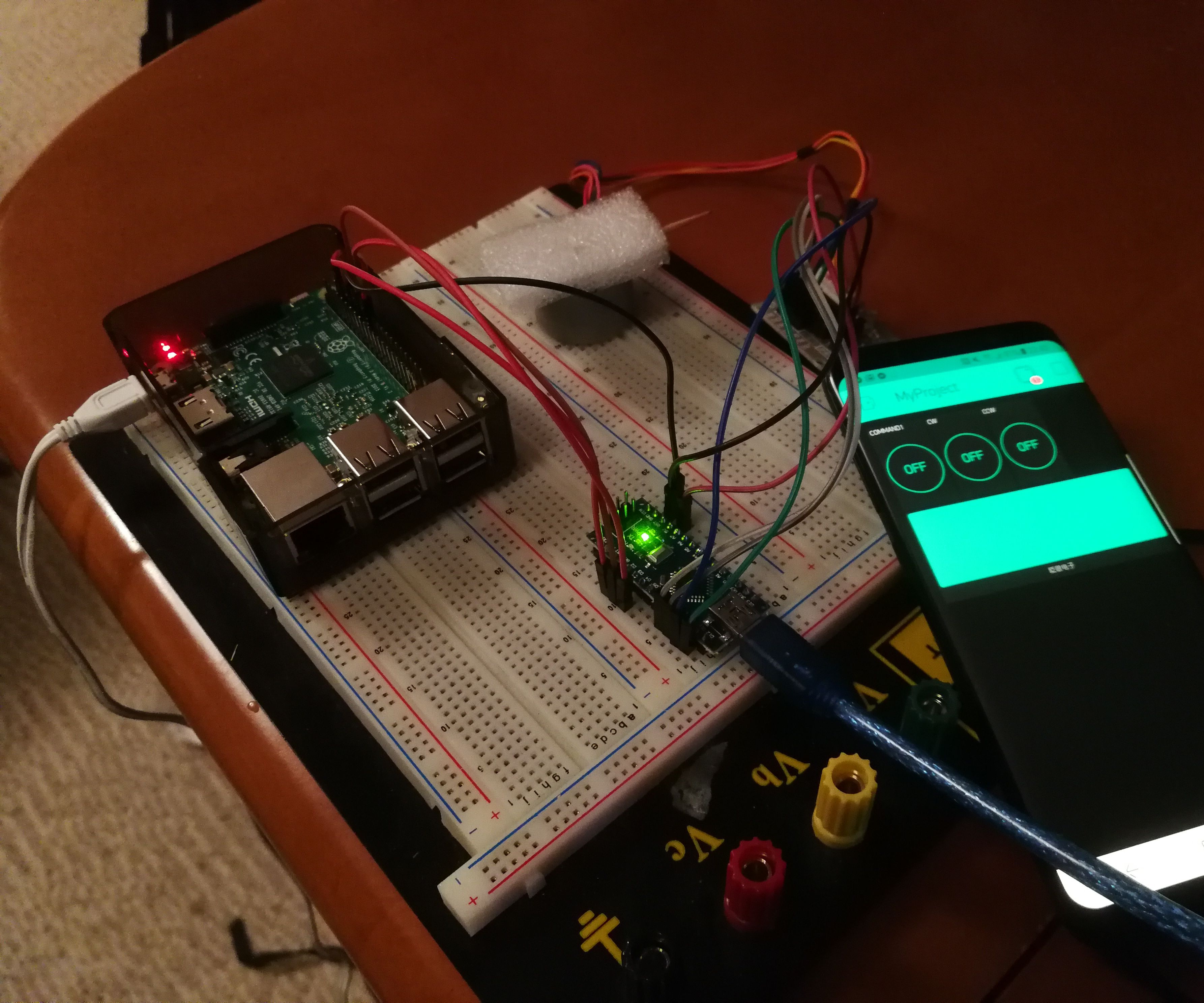

Introduction: Arduino LED Controller With WPF
The purpose of this project is to control an LED connected on an Arduino with a WPF application using serial communication.
For this project I will be using an Arduino Nano but feel free to use whatever kind of Arduino (Uno, Mega, etc...)
All the files required for this project are included in this tutorial.
This is a basic tutorial that gives you the opportunity to easily implement more functions and hardware to this project. For the sake of this tutorial, I kept it simple so that it is easier to understand.
If you want to know more about certain function or syntax used in this code, I would recommend you to go check out https://www.arduino.cc/reference/en/ for more detail information.
Enjoy!
Step 1: Connect Your LED
