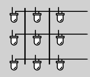

Place this LED into your template and repeat this for every LED in the layer. When all 9 LED's are placed. Solder the negative sides together. Try to keep the solder not too long near the LED as the temperature might burn the LED down. The 3 negative sides that are on the outside can be cut in half using a plier.
Now place 2 conducting wires between the rows and solder them together so they're all connected, see the figure.
If you use transparent LED's paint the bottom side of the LED's to prevent false light in the upper layers. I painted the bottom with white acrylic paint.
