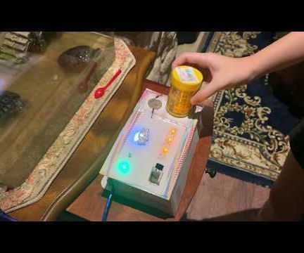

This project is called Arduino LED dice + speaker.
There are 7 LEDs with different colors, a button, and a speaker.
How it works:
When you press on the button, you would hear a sound from the speaker, and the LEDs would randomly choose a number from 1 to 6. After about a second, the LEDs would turn off and you could press the button again to choose another number. It is like the dice we use when playing board games.
The video above shows how it works, and the pictures display the look from different sides.

  1. Place the LEDs on your breadboard in the shape of "H (as shown in the diagram)
  2. Connect the cathodes (-) of all the LEDs to ground (-) with the resistors
  3. Connect the 4 groups of LEDs (as shown in the diagram)
  4. Connect the groups of LEDs to D pin (as shown in the diagram)
  5. Put the button on the breadboard and connect it to ground (+) with 10k ohm resistor, another side to D pin
  6. Put the speaker on the breadboard and connect it to ground (-) and to D pin
The dice should follow the rules:
For no.1 of the dice: lights up the LED 4
For no.2 of the dice: lights up the group 1
For no.3 of the dice: lights up the groups 3 and 4
For no.4 of the dice: lights up the groups 1 and 3
For no.5 of the dice: lights up the groups 1, 3 and 4
For no.6 of the dice: lights up the groups 1, 2 and 3

Step 5: Test It!
The last step is to try and test if your project works!
Here are some more pictures of my project: LED dice from 1 to 6.
