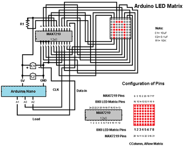

Step 2: Diagram
The diagram is a real representation of your project because it is a step by step of each connection between its components. Also, there is a description of pins of the main components involved in the project.

Step 7: Wiring the Bottom Side of 8x8 LED Matrix
For wiring the bottom side of 8x8 LED matrix, pins from 1-8; left to right, I´m using yellow wire and checking carefully the connections in the project´s diagram. Then remember 8x8 LED Matrix´s pins 1,2,3, 4, 5, 6, 7, and 8 will be connected respectively to MAX7219´s pins 20, 14, 11, 6, 22, 3, 16, and 21.
Step 8: Wiring the Top Side of 8x8 LED Matrix
For wiring the top side of 8x8 LED matrix, pins from 9-16; right to left, I´m using orange wire and checking carefully the connections in the project´s diagram. Then remember 8x8 LED Matrix´s pins 9, 10, 11, 12, 13, 14, 15, and 16 will be connected respectively to MAX7219´s pins 17, 7, 10, 23, 2, 15, 5, and 8.
Step 9: Completing the Project
So that you can complete the project, you should connect the resistor of 10K between the pins 18 and 19 of the integrated circuit MAX7219. Once done the previous step, work with MAX7219´s pins 1, 12, and 13 to be connected respectively to Arduino Nano´s pins A2, A1, and A3.
