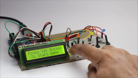

Step 1: Connect Led and Buttons
Instead of making a very messy wiring setup i simply used breadboard, This breadboard not only helps to make the connections easily but also serves the purpose of a console in our game!
Let me make the circuit simple easy for you, Here we have LED and the buttons.
The ground of all the LED and button will be connected to the negative power rail of the breadboard and this will be connected directly to the gnd pin of the UNO board.
Here there is one catch, the LED and buttons are arranged from right to left.
Right button and LED are number from 1 to 4, so you need to follow this order when making the connections.
Toggle buttons are connected from D2 to D5 and the LED pins are connected from D8 to D11.
SDA to A4 and SCL to A5 from LCD is connect to Uno followed by the Gnd and 5v pin directly to the uno.
I have used the same system to make the connections and you can see that in this step.

Step 3: How to Play
Playing is easy like plug and play device! all you have to do is connect the board to USB power source using USB cable.
LCD will show a message to press the first button pres the button from the last left side and now the game will begin.
At first the single LED will glow and now you have to press the button below that LED if you got it right the game will move to next level that is level 2.
In level 2 instead of one LED the 2 led will glow in random order and now you have to press the right button to move to next level.
If you are not able to get this right the game will start from the beginning, i think up to level 4 anyone can play later the real game begins from level 5 where you have to guess the correct order, set this game at your house parties and have fun.
