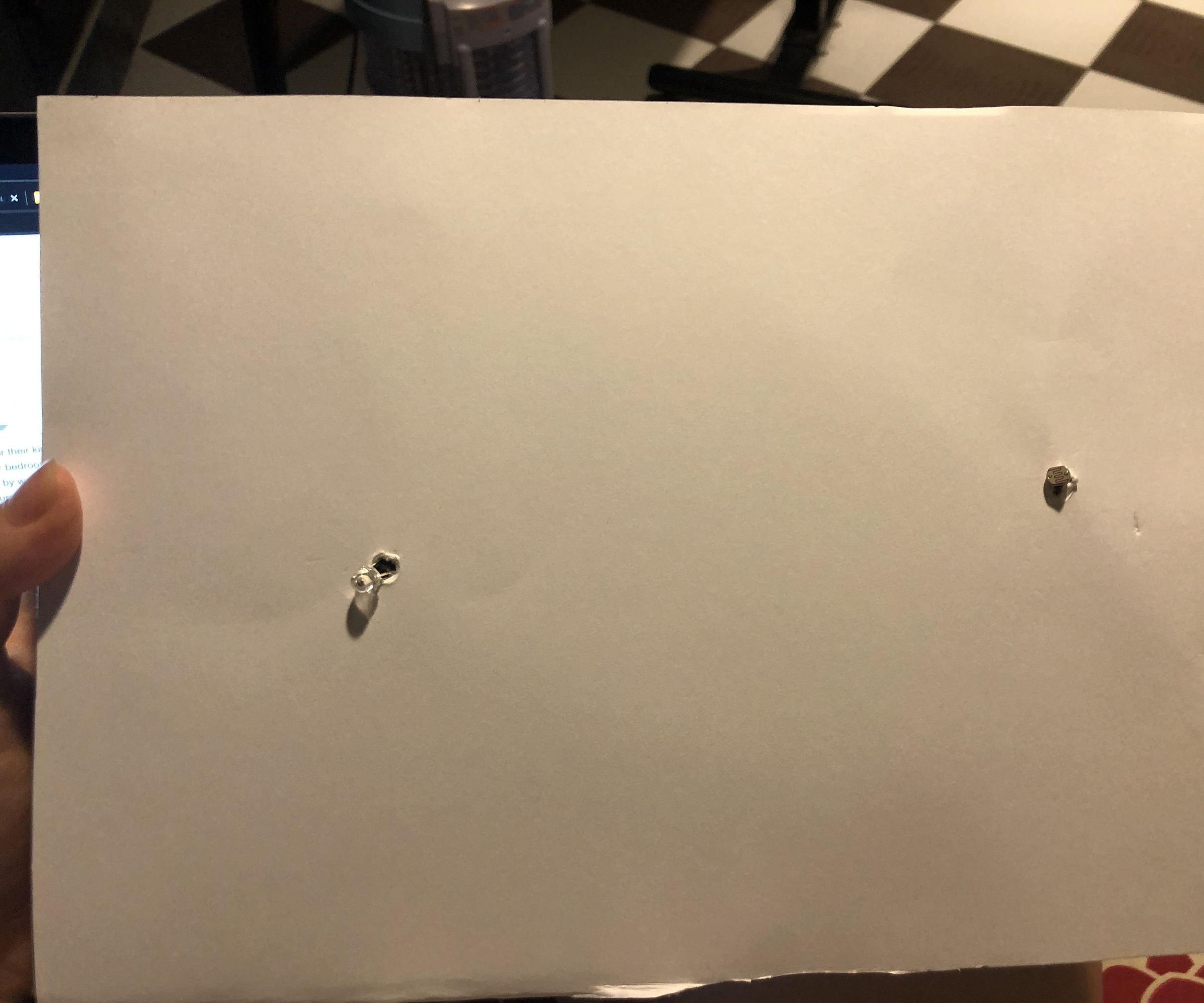

Step 4: Testing
So now the LEDs and the speaker will work when you press the button.
I put it in a box to cover the cables and other stuff to make it prettier and neat. Only a hole for the lights and the button will be sticking on the top of the box.
