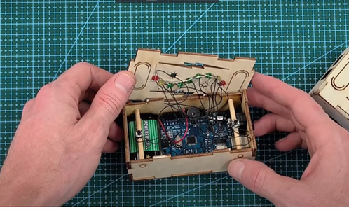

Step 2: Create the Box
I used a laser cutter to cut the box out of 3mm wood panels, the below cad files are below including the drawings in google sketchup
Step 3: Solder the Wires
Solder the Leds and other components together, use header pins to plug into the ports of the Arduino
