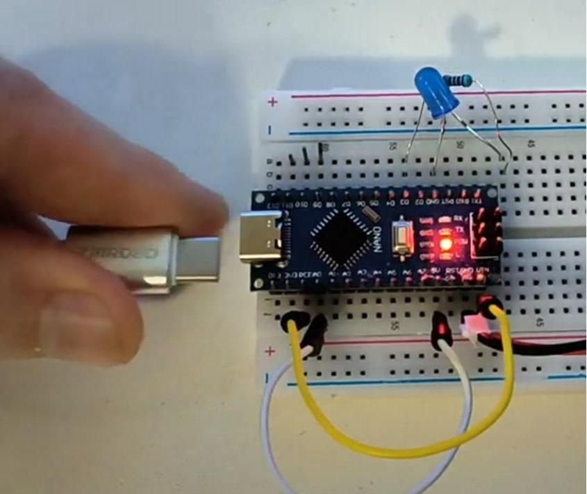

Step 5: Solder 3PIN to D4,5,6
Solder three pins to digital ports 4, 5, and 6 on the Arduino Nano. Once soldered, bend the pins horizontally so they can be connected to the LED strip contacts for GND, DATA, and 5V.
Insert the switch pin into the GND port of the Arduino Nano.
Step 6: Solder Speaker
Solder the second leg of the button to GND.
Solder the positive wire of the speaker to digital pin 13.
Solder D2 to the push button.

Step 8: Solder Battery Charger
Solder the positive and negative wires of the 3.7V battery to the TP4056 battery charger.
Using thicker wire, solder the positive wire to the 3-pin terminal of the power switch and the negative wire to VIN on the Arduino Nano.
Apply a small amount of hot glue under the charger and battery to secure them to the board.
