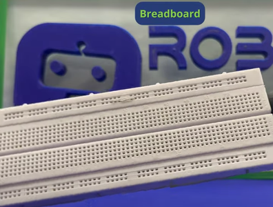

The goal of this project is to create an interactive LED Reflex Game using an Arduino. The game lights up LEDs in sequence, and the player must press a button when the red LED lights up. If the button is pressed in time, the buzzer beeps and the player scores a point. This game challenges your reaction time and is fun and easy to play. It uses simple components and basic coding but allows for customization and enhancements. Perfect for beginners aiming for an A+ project.

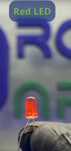

  3. 12 LEDs (11 green, 1 red)

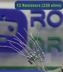

  4. 12 resistors (220Ω) or (330Ω)

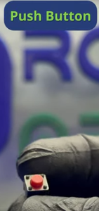

  5. 1 push button

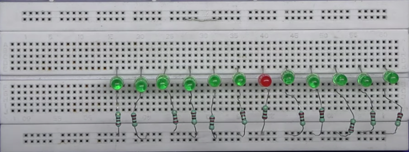

Step 1: Place LEDs
Start by placing all 12 LEDs on the breadboard. First 5 green LEDs, and then one red LED, and then the remaining 6 green LEDs.
Step 2: Place Resistors (220Ω) or (330Ω)
Connect the cathode that is a short led of each LED to one end of (220Ω) or (330Ω) resistor. Connect the other end of the resistor to the negative rail of the breadboard.
Step 3: Arduino Pins
Now where the LED anodes the long lead to the Arduino pins. First five green LEDs to digital pin D2, D3, D4, D5, and D6. And then the anode of red LED to pin D7. Then connect the remaining anodes od green LEDs to pin D9, D9, D10, D11, and D12 in proper sequence.
Step 4: Push Button
Next, place the push button on the breadboard. Connect one leg of the button to the negative rail. Connect the other leg to analog pin A1.

Step 6: Connect Ground
Finally connect the G&D of Arduino to the negative rail.
Step 7: Check Connection
Double check the connection with he circuit diagram to avoid short circuits.

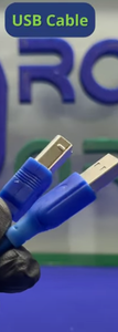

Step 9: Connect to Computer & Play!
Now upload the code to the Arduino. Connect the Arduino UNO to your computer using the USB cable for uploading the code. Select port and board in the same menu and select Arduino UNO. Now clock on the upload button. Once uploaded, Power your Arduino. The LEDs light up one by one in sequence like a chaser. The red LED is a target LED. When you press the button exactly when the red LED lights up, you win. If you press it at the wrong time, the buzzer gives you a sad tone. A successful press triggers a happy double beat.
