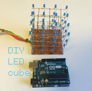

This project requires some soldering expertise, but its an easy one and perfect for Arduino beginners.
Step 1: PARTS
parts I used:
* arduino UNO

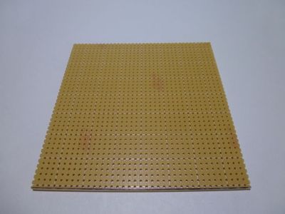

* PCB board
* 64x diffused LEDs
* wires from ethernet cable
* 20x male pins for Arduino
* 20x shrink tubes
* 4x 100 OHM Resistors

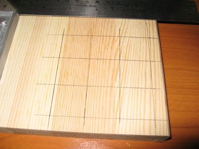

Step 2: The Cube
drill 16 holes in a cardboard box or in wood for the layers to be held in place while you soldier them.
