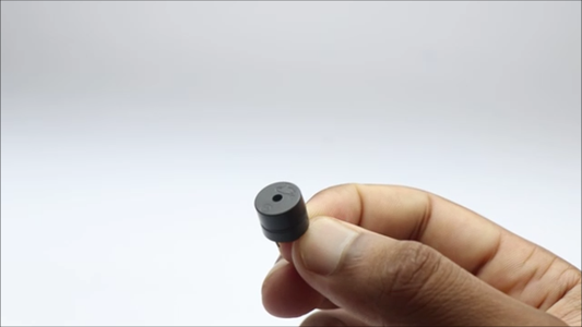

Buzzer small

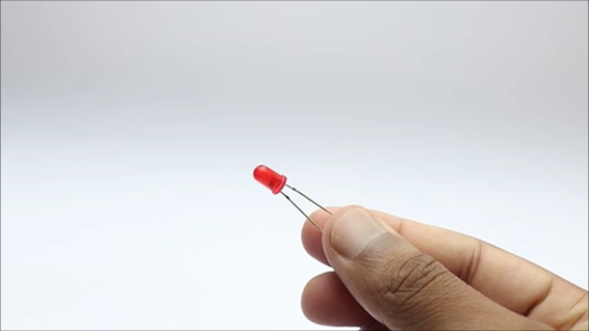

LED

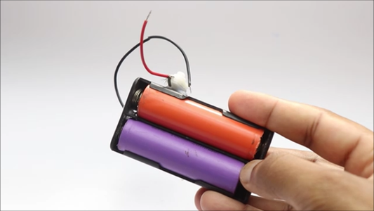

18650 Battery with holder and switch

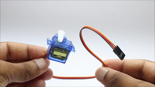

Servo Motor/ micro servo

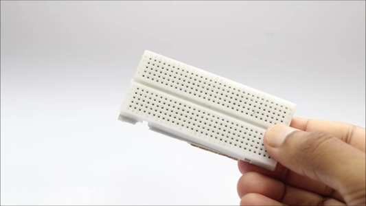

Breadboard (optional)

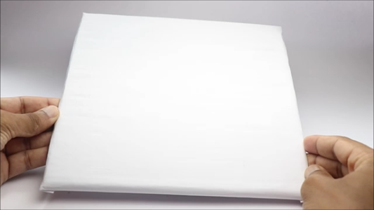

Piece of cardboard

Buzzer
Positive which is longer leg is connect to digital pin 8 on the Arduino
Negative (shorter leg) is connected to GND on the Arduino
Servo Motor Connection
Red Wire to 5V on the Arduino
Brown Wire to GND on the Arduino
Orange Wire to digital pin 9 on the Arduino

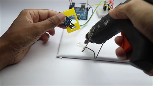

After we have all the components connected to each other we can place it on the piece of cardboard, i had a few pieces of 3d printed parts which served the purpose of holding the gas sensor and the servo
You can also use piece of cardboard or if you have a 3d printer you can print similar shapes to hold the sensors
Use a decent amount of hot glue so that the parts are firm on the cardboard.
I started by using double-sided adhesive on the nano, later worked on gluing the gas sensor and followed by the breadboard and the gas regulator
Here since we have moving parts make sure the regulator and the servo are glued well and wont shake when it is working
This is not only the way you can set this up as per your requirements as of my requirement i found this the most appropriate.

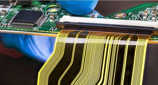

Check Here for Rigid-flex Pcbs with this your circuit becomes flexible! I have added the images to this step kindly check.
A revolutionary solution that combines the best of both rigid and flexible circuitry to elevate your electronic projects to new heights.
With their expertise in advanced manufacturing techniques, they offer a seamless integration of rigid and flexible components, ensuring enhanced reliability, durability, and space-saving benefits.
