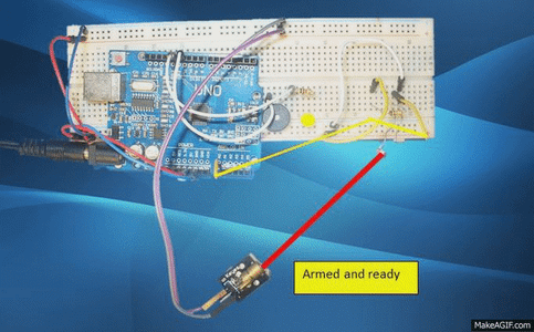

Step 1: Breadboard:
First make sure your Arduino is turned OFF.
Plug two jumper wires into the power row on the breadboard, plug one end of the Buzzer into GND and the other into Pin 7.
The led is plugged into GND and Pin 13 with a 1K resistor and the Photoresistor into GND and the other end has a 10K resistor is plugged into 5v.
Then plug in a jumper wire from the same pin were the Photoresistor and 10K resistor meet into Pin AO.
Step 2: Upload Code to Arduino
Plug your board into your computer and upload.
You may need to adjust the code to work with your lighting.

Step 4: Setup
Place the laser some were and aim it at the Photoresistor.
Turn one your Arduino and your done!
