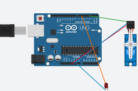

Step 2: Build Circuit
Build the following circuit. Note that the LED represents a laser diode.

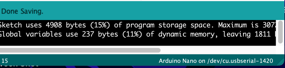

Download and run the "laser clock.py" file on your computer, with Python. If you get an error saying that a library is not installed, it is likely that you do not have the serial library installed on Python. To install it, go to your devices command line and enter "pip install pyserial".
Step 9: Serial Port
To get your laser clock up and running, the final thing that you have to do is to adjust the serial port in the Python file. Where the file says "arduino=serial.Serial('/dev/cu.usbserial-1420', 9600)", change the first argument of the serial.Serial function to the information on the bottom right of the Arduino window. In the image provided here, that is "/dev/cu.usbserial-1420"
