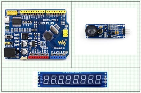

Parts and components
Arduino Uno board = 1 No
Laser Proximity Sensor = 1 No
MAX7219 Seven Segment Display Module = 1 No

The laser proximity sensor has three signals:- VCC, GND and DOUT.
Sensor Dout pin is connected to D5 digital IO pin of Arduino.
The MAX7219 display module provides a 3-wire serial (SPI) interface to drive 7-segment LED displays (common-cathode type) up to 8 digits.
The on-chip includes a BCD decoder, multiplex scan circuitry, segment and digit drivers, and an 8×8 static RAM to store the digit values.
The DIN, LOAD and CLOCK pins of MAX7219 is connected with 4,2 and 3 digital IO pins of Arduino.

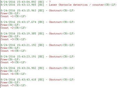

When debug flag is enabled at compile time, then the software will sends the debug information to serial port.

The project is successfully completed with Arduino UNO, Laser Proximity Sensor module and Max7219 Seven segment display module.
The laser module will generate the laser, and whenever the laser light is interrupted, then writes a high level on its digital pin.
The obstacle detection, line count will be shown on connected display, as well as serial port print message.
