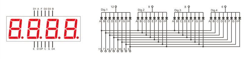

Seven Segment Display Connection
A Seven-segment display (SSD), or seven-segment indicator, is a form of an electronic display device for displaying decimal numerals that is an alternative to the more complex dot matrix displays. Seven-segment displays are widely used in digital clocks, electronic meters, basic calculators, and other electronic devices that display numerical information.
In this Kit I used 4 digit 7 segment display and multiplexing technique will be used for controlling the display. A 4-digit 7-segment LED display has 12 pins. 8 of the pins are for the 8 LEDs on each of the 7 segment displays, which includes A-G and DP (decimal point). The other 4 pins represent each of the 4 digits from D1-D4.
Each segment in the display module is multiplexed, meaning it shares the same anode connection points. And each of the four digits in the module have their own common cathode connection point. This allows each digit to be turned on or off independently. Also, this multiplexing technique turns the massive amount of microcontroller pins necessary to control a display into just eleven or twelve (in place of thirty-two)!
What multiplexing does is simple – show one digit at a time on a display unit and switch between display units very fast. Due to persistence of vision, human eye can not differentiate between which display is ON/OFF. The human eye just visualizes all the 4 display units to be ON all the time. Let’s say we need to show 1234. First we turn on the segments relevant to “1” and turn on the 1st display unit. Then we send signals to show “2”, turn off 1st display unit and turn on 2nd display unit. We repeat this process for next two numbers and switching between display units should be done very fast (about within one second delay). As our eyes can’t pick a change occurring repeatedly to any object within 1 second, what we see is 1234 appearing on the display at the same time.
So, by connecting digits common cathodes to ground we are controlling which digit shall be turned on. Each Arduino pin can drain(receive) maximum 40 mA current. If all one digits segments are on, we are having 20×8= 160 mA that is to much, so we can’t to connect common cathodes directly to Arduino ports. Therefore I have used BC547 NPN transistors as switches. The transistor is on, when a positive voltage is applied at the base. To limit the current I used a 4.7K resistor to the base of the transistor.

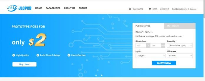

JLCPCB manufactures 5pcs of PCBs with maximum size 10cmx10cm in just 2 dollars. This is the cheapest price we have ever seen. The shipping charge is also low as compared to other companies.
For ordering visit the JLCPCB website. The home page displays a quotation calculator that takes you to the ordering page. On the quotation calculator, simply enter the size of the PCB, quantity, layers and thickness.
The quote page has an excellent default setting for beginners who do not understand all the PCB manufacturing terms and standards. For example, the terms like Surface Finish, Gold Fingers, Material details, etc. can be confusing for hobbyists, so, you can just avoid those settings. The default setting is all good. If you want to know the meaning of those terms and want to figure out what’s their significance on your PCBs, you can simply click on the question mark right above the terms.
For example, JLCPCB has well explained the term Gold Fingers, Material details, etc. If you are a beginner, you just need to set the PCB dimensions, layers, color, thickness and the quantity you need. Other default settings can be kept as they are.
