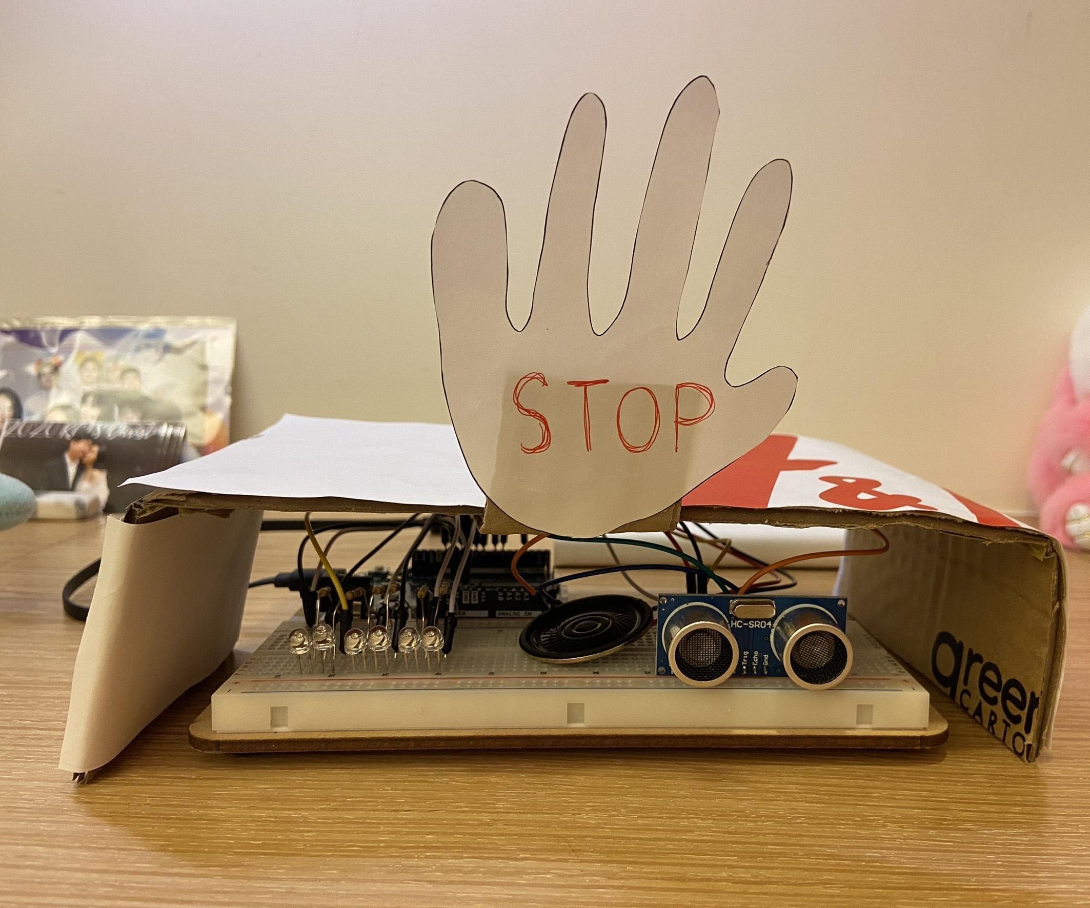

Introduction: Arduino Led Game
stimulating human eyes, the machine can help children learn different colors.
Inspired by:https://www.instructables.com/Arduino-Led-Mini-Gam...
LED LightsButtons Alligator Clips with Pigtails Various kinds of Wires Shoebox
Step 1: Coding
Set up the lights controlled
程式碼:https://create.arduino.cc/editor/weiyi_chou_/7a976b0b-f1a7-4ae3-8215-6ff2abd6b2b1/preview
Step 2: Changing It Up
int tap1 = 0;int tap = 0;void setup(){Serial.begin(9600);pinMode(13,OUTPUT);pinMode(12,OUTPUT);pinMode(11,OUTPUT);pinMode(10,OUTPUT);pinMode(9,OUTPUT);pinMode(8,OUTPUT);pinMode(6,OUTPUT);pinMode(4,INPUT);}void loop(){blue1(); button(); green1();button(); yellow1(); button();red(); button(); yellow();button(); green(); button();blue(); button(); green3();button(); yellow3(); button();red2(); button(); yellow2();button(); green2(); button();}void blue1(){if(tap == 0){digitalWrite(13,HIGH);delay(200);//改digitalWrite(13,LOW);tap1 = tap1 + 1;}}void button(){tap = digitalRead(4); Serial.print(tap);if(tap == 1){if(tap1 == 1){digitalWrite(12,HIGH);tone(2,100,20);delay(1); digitalWrite(12,LOW);}if(tap1 == 2){digitalWrite(11,HIGH);tone(2,100,20);delay(1);digitalWrite(11,LOW);}if(tap1 == 3){digitalWrite(10,HIGH);tone(2,500,20);delay(1);digitalWrite(10,LOW);}if(tap1 == 4){digitalWrite(9,HIGH);tone(2,100,20);delay(1);digitalWrite(9,LOW);}if(tap1 == 5){digitalWrite(8,HIGH);tone(2,100,20);delay(1);digitalWrite(8,LOW);}if(tap1 == 6){digitalWrite(6,HIGH);tone(2,100,20);delay(1);digitalWrite(6,LOW);}if(tap1 == 0){digitalWrite(13,HIGH);tone(2,100,20);delay(1);digitalWrite(13,LOW);}}}void green1(){if(tap == 0){digitalWrite(12,HIGH);delay(200);//改digitalWrite(12,LOW);tap1 = tap1 + 1;}}void yellow1(){if(tap == 0){ digitalWrite(11,HIGH); delay(100); digitalWrite(11,LOW ); tap1 = tap1 + 1;}}void red(){if(tap == 0){digitalWrite(10, HIGH);delay(200);//改digitalWrite(10,LOW);tap1 = tap1 + 1;}}void yellow(){if(tap == 0){digitalWrite(9,HIGH);delay(200);//改digitalWrite(9,LOW);tap1 = tap1 + 1;}}void green(){if(tap == 0){ digitalWrite(8,HIGH); delay(200);//改 digitalWrite(8,LOW); tap1 = tap1 + 1;}}void blue(){if(tap == 0){digitalWrite(6,HIGH);delay(200);//改digitalWrite(6,LOW);tap1 = tap1 - 1;}}void green3(){if(tap == 0){digitalWrite(8,HIGH);delay(200);//改digitalWrite(8,LOW);tap1 = tap1 - 1;}}void yellow3(){if(tap == 0){digitalWrite(9,HIGH);delay(200);//改digitalWrite(9,LOW);tap1 = tap1 - 1;}}void red2(){if(tap == 0){digitalWrite(10,HIGH);delay(200);//改digitalWrite(10,LOW);tap1 = tap1 - 1;}}void yellow2(){if(tap == 0){digitalWrite(11,HIGH);delay(200);//改digitalWrite(11,LOW);tap1 = tap1 - 1;}}void green2(){if(tap == 0){digitalWrite(12,HIGH);delay(200);//改digitalWrite(12,LOW);tap1 = 0;}}
Step 3: Structure of the Device
Step 4: Design the Exterior
Step 5: How It Operates
https://youtu.be/xK2IvNgtcpI
