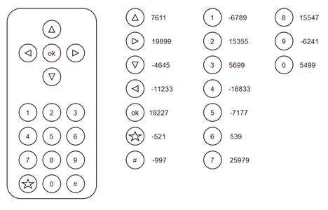

Step 4: Find Channels
Add the following code to your loop:
void loop() {
  if (irrecv.decode(&results)){
    int value = results.value;
    Serial.println(value);
Now you print the values (in your serial monitor) of the remote controller when a button is pressed. So you can find out the value corresponding to every button. For example, you upload your code to your Arduino and opened the serial monitor, when you press now button 1, there will be print a value like -6789. Do this for all your buttons and write then down (like the picture above).
Step 5: Print Button Values
Now add switch statements to get your serial monitor to print which button is pressed. Notice the values can be different for your specific remote controller.
