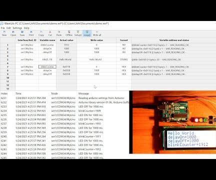

Another interesting aspect of this demo is how to access Arduino variables real-time from the PC just like you would do with a PLC. WawiLib-PC is used to read and write the Arduino variables that control the Lego setup.

Step 4: Arduino Coding.
The source code contains code to link the variable photoCellOn with digital output 3. Output 3 feeds the LED in the photocell. ObjectDetected reflects the state of digital input 2. Input 2 is connected to the PT334.
Do note that digital input 2 is initialized as INPUT_PULLUP so the PT334 can function as an open-collector device. This means that once the PT334 is lit, it will drain current from its collector to its emitter. This will cause voltage drop over the pull-up resistor in the Arduino. Due to the voltage drop, the input of the Arduino will see a low voltage. This effect creates a logic '0' state on the digital input of the Arduino processor.

Step 5: Final Demonstration.
This movie contains 2 parts:
1) The simple demo where an Arduino UNO activates an output connected to the photocell LED and shows the status of the sensor (covered or not).
2) A more advanced demo where the Lego motor controls a rotating Lego bar.
The position of the Lego bar is reflected in a variable rotActual. When it turns forward 1/2 revolution, the value of rotActual is incremented. When the bar turns backwards 1/2 turn the value of rotActual is decremented. The Lego photocell triggers the increment or decrement of rotActual.
There is a value rotSetpoint where the user introduces the target value of the rotating bar.
The variable machineStatus contains a string with the actual status of the machine (on/off etc...).
The Arduino Mega controls 4 relays feeding the Lego motor; Rotating backwards is done by inverting the polarity of the Lego motor connections using 2 of the 4 relays.
The motor controls the rotating bar via the Lego gear box so the bar follows the target value in rotSetpoint just like a simple servo.
WawiLib-PC is used to read and write the values of the Arduino variables using the Arduino USB programming port. For additional info about WawiLib-PC: www.SylvesterSolutions.com
