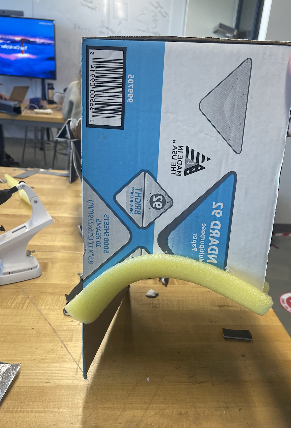

Step 5: Make the Ground
  • Cut the one of the front panels on the box off, sort of making a window in the box.
  • Then cut two arches in the sides of the box.
  • Cut a pool noodle in half and then cut that half in half again vertically making two quarter noodles for each side of the box.
  • Hot glue the noodles to the cut sides of the box.
  • Fold aluminum 3 - 4 times to make strips and glue them roughly 2 inches from the top of the box on every side (its okay if it too long it will get folded over).
  • Fold the ends of the strip over the sides of the box.
  • Glue the pieces of folded aluminum to the button and the folded over end of aluminum on the right side. That will complete the ground for the controller.
  • Add a piece of electrical tape over for extra security and conductivity.
