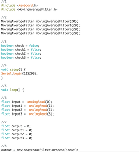

Step 9: Downloading the Code
Download the Arduino software HERE
Copy and paste the DIY Makey Makey Code into the Arduino.
Change the inputs from letters to Space and arrow keys: Ex: Keyboard.print("d") into Keyboard.print("RightArrow"). A to left arrow, w to the space bar, and d to right arrow.

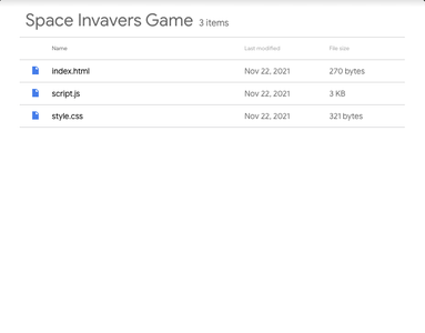

Here are all the files for the space invader game that you will be playing: Space Invaders
To play the game, open the HTML zip file. Change the javascript from UpArrow to the space bar. Do this by just pressing the space bar. Ex: "ArrowUp" to " ". You can change how the game looks using CSS.
