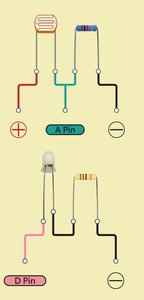

Step 1: Step 1: Assembly Resistor on Arduino Leonardo
Follow the picture and place the materials on the right place.

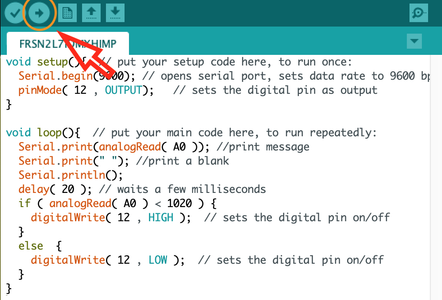

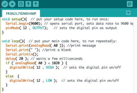

Step 2: Step 2: Start Write Down the Arduino Code
copy down the code
code link: https://create.arduino.cc/editor/enyalin11/9d1ef1...
If you don't know how to type a code, you can also use ArduBlock. here is a link of how to download ArduBlock : https://www.davidhuanglab.com/ardublock
Step 3: Step 3: Write Down Your Own Reminder
Using paper and marker, design your word, structure... everything you want.
Step 4: Step 4: Upload the Code
connect USB cable on the computer, click upload on the computer.
